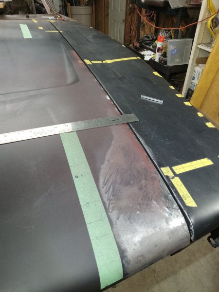

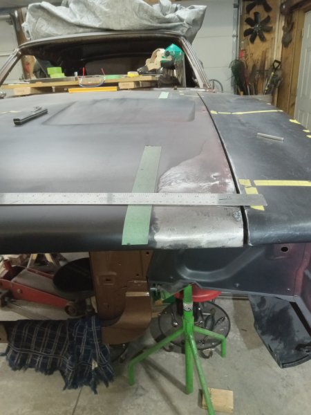

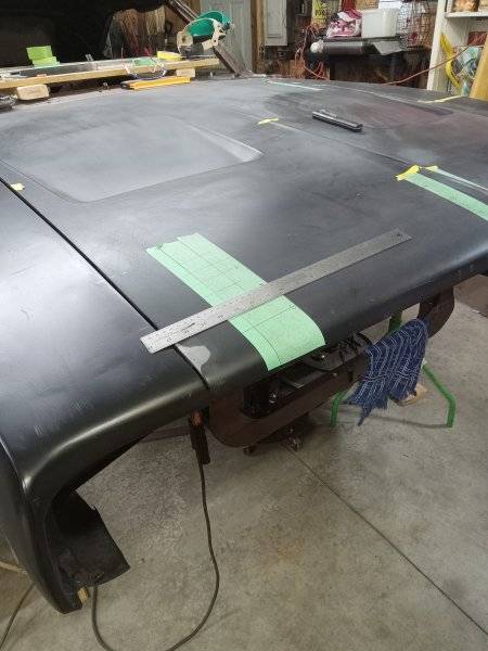

So I have a problem with the profile of the hood not matching the fender.
I don't expect perfection but this seems a bit off.
The hood was damaged on the drivers side leading edge and I am sure this is why it is off as the passenger side is good.
I have already split the hood (bare metal area) and got the profile to match much better, but I am still off.
I am thinking of using USC All-Metal along the edges but am wondering if this would not work well as the hood gets shut. Could the All-Metal chip of fall off?
Wondering how the body guys would fix this????

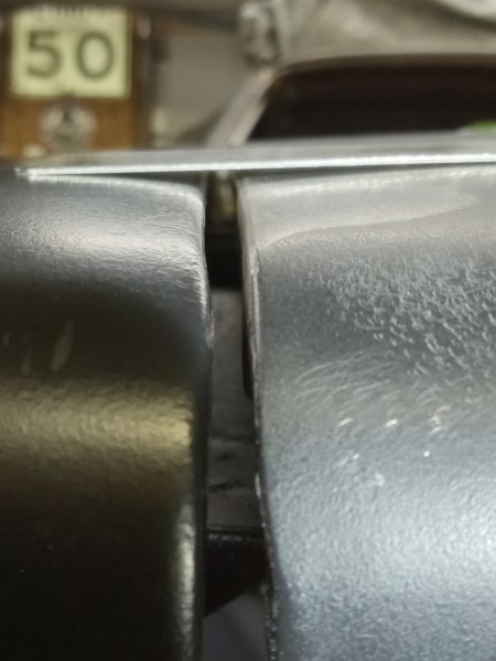

1st position

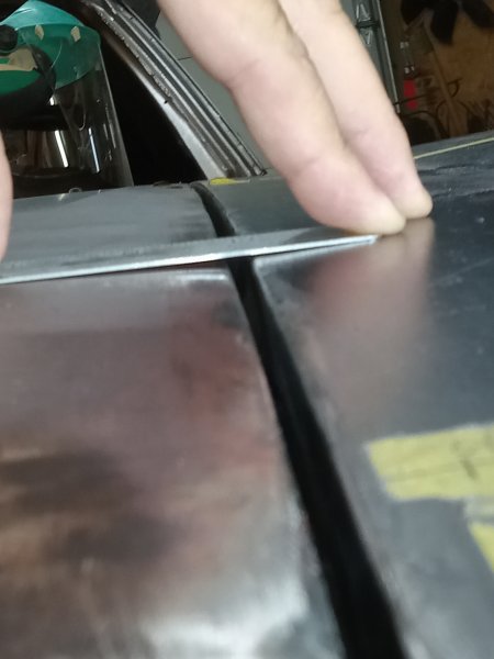

close up
the hood drops about a 1/16

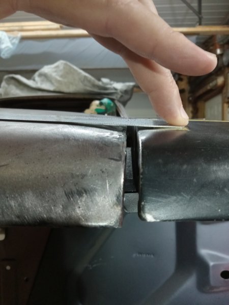

2nd position
Hood is about an 1/8 lower than the flexible ruler

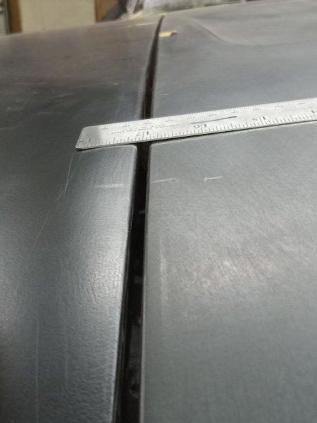

Comparing to the passenger side

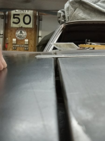

1st position
2nd position
The hood and fender drops about 1/16 or less

I don't see any other practical way of leveling this out if you want a perfect finish. Chip Foose would lay and 1/16th of filler over the entire car.
Why is USC all metal better than a quality bondo?
I know it is used in place of lead joints. Roof to quarter seam, quarter to rocker seam, and a-pillar to cowl seam.
It has aluminum added to give it more strength.
It does not hold moisture like normal filler.
Not applicable for me but it can be powder coated.
whatever it takes Don......... I've cut/split/welded in severe cases......... I had issues twice where someone didnt rough up the metal under all metal and it let go; that's not the all metal's fault......... it likes it rough
you could build up the edge with weld to fill the big voids, then fill
you could get 1/16 rod and panel bond it to the edge where needed, once cured you can grind into shape and fill it
you could also use body filler as the quick fix and no one would know unless you whack it with a hammer
I'm no bodywork expert, and I'm sure this wouldn't be easy, but it seems both the droop and the inward gap could be resolved if the corner of the hood edge could be carefully twisted or bent back up. That would both level the front edge and narrow the gap. That's the reverse direction of how it likely got damaged.
marine tex?
If you had some sort of custom fixture, a way to hold it and a tiny pull on the last 1/16" or so.
Anything"straight" has at least a "skim" coat
I see people add filler to the ends of door at the strike end to flush it out to the quarter all the time. Door get opened and close a lot more than a hood. Am I missing something? Seems like it would be ok. Yes?
