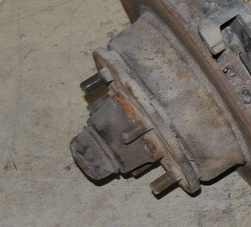

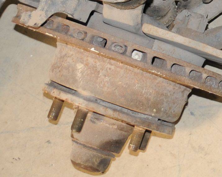

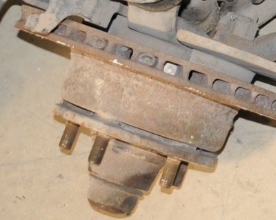

It's a Kelsey Hayes 2 piece - rotor & hub 5x4.5 - been bugging me for a while, see pic
snook
Kelsey Hayes was small bolt pattern. Isn’t that one large bolt pattern?
we also had Bendix for 66-69 B bodies and Budd for C bodies in 4.5 and 5” bolt pattern.
It's definitely kelsey hayes. The studs are stamped KH and it's cast into the rotor. 4.5" bolt pattern.

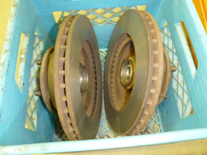

Well if they are on my SBird they were on any '70 Road Runner built in November / December 1969. Mine in the milk crate, first time they were turned in 50 years, 56,520 miles.
