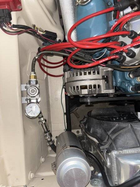

I want to add a fuel filter that has a return line and I’m questioning myself as to where to put it. Since it has a return port, should it go before or after the pressure regulator? My current setup is pictured below.
If using a stock mechanical pump, I typically will put a filter directly after it to protect systems down flow... like a regulator and carb. If electric pump, pre and post pump, with tighter filter (lower micron) on the post side, which is before the carb/regulator.
That’s what I have now. The clear one in the picture. I wasn’t sure if a filter with a return line should be before or after the regulator. I’m trying to cut down on a heat soak problem.
I installed a filter with a return line after the pressure regulator, ran the return line back to the tank. I left the clear filter that’s before the regulator for visual purposes and extra filtering.
I started the car and the fuel pressure gauge was all over the place. I’m assuming that the return line is causing it to not hold pressure anymore. If I eliminated the pressure regulator would it still run fine you think? The car didn’t seem to have the giddy up it did and I can only assume it’s due to the wonky fuel pressure now.
Not sure if you have a carb or efi.
I have efi, the filter below is both a filter and a regulator that maintains 58psi and it is mounted very close to my gas tank.
In essence, my return line is after the regulator/filter, and the main line runs all the way up to dual throttle bodies without any loss in psi.
Based on that, I don't understand why your return line after the regulator would cause a loss in pressure.

I’m running a simple Holly 600. I just find it strange that the gauge started jumping after installing the filter. I think I’m going to bypass the regulator and put a gauge just before the carb to see what that does.
