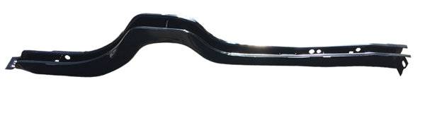

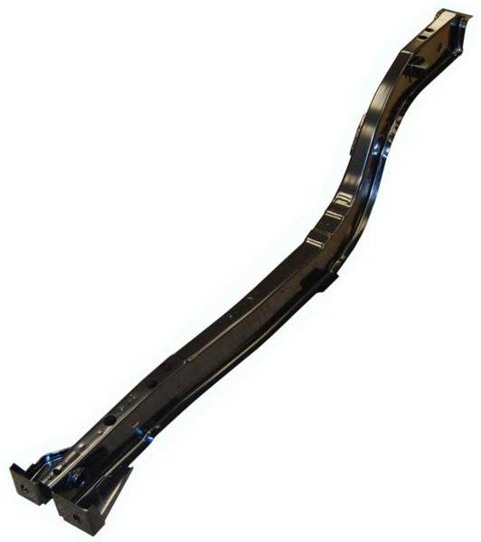

After getting it home and getting on the lift....I was sick. The rear frame rails have a little rot back near the rear spring hanger area. Its solid if you go forward about 12 inches from the back bumper. Does anyone sell a partial frame rail that I can splice in ? I want to just cut out the bad part...obviously I'll go a few inches forward of the rot. Also needs a trunk floor. I see trunk floor extensions, and complete trunk floors. If you buy the complete floor, do you still need the extensions ?

They all have rust in those areas. The complete trunk does not include extensions. Rear frame rails are available. Relax, bear down, and get er done, it's doable and minor.

You can get all the exact pieces you need. Cut out the trunk and extension, redo the rear frame rails then weld in the trunk pieces. Driver floor can be welded in at any time before or after.
