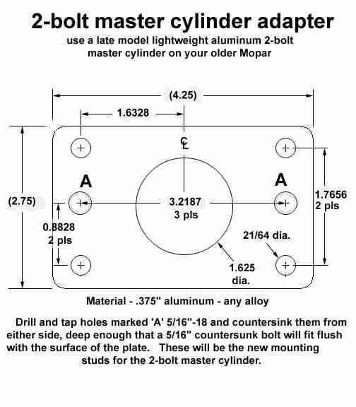

Thats an interesting adapter plate. Ill have to take a look at that.
Ill check to see if the surface of the bowl is true or not. I was wondering about that myself. Maybe there is a low spot. Thanks yall
Those adapters come up occasionally on ebay.
Price can vary quite a bit. $15 to over $50.
Some Mopar resto sites sell them as well.
Might have to adjust push rod length.
...you can also make one out of a bad M/C, the metal to make one probably costs more than the core you'll get, and it already has most of the holes drilled in exactly the correct spots.
Ok thanks guys. Theres a great metal fab shop here that could make that adapter for me easily. Im going to try this other reman i have this weekend and see if it leaks. If so, ill look into this adapter yall are talking about. Is there a particular master cyl people use?
