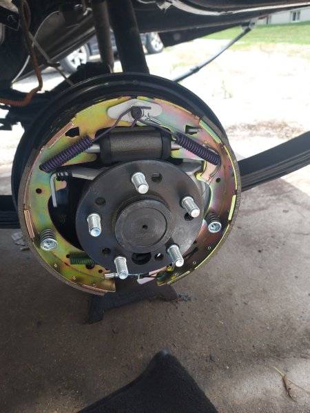

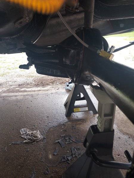

Just finished up on the rearend Dr. Diff axles with green bearings and inner seals , 742 3rd member alburn pois. New backing plates With new bearings and 3.91 gears. New bilstien shocks and bushings for the springs and new shackles. Just have to run new brake lines
Time and money well spent.
I need to run new brake lines also.
Looks good !
