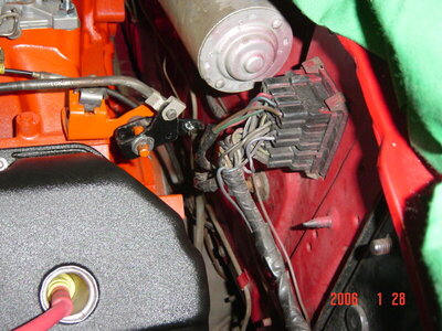

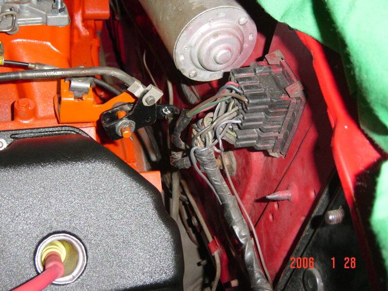

What was used to plug off the holes for the starter relay on the firewall when it was relocated to the left fender area on 66 Hemis - screws, rubber plugs, dum-dum?? Here is a picture of my 67 showing the general area where the relay is mounted on other-than-hemi cars, although I think in 67 it was shifted over to the outside to clear the valve covers.

I see dimples. Looks like the the insulation stud is cutoff on AR67GTX's photo.

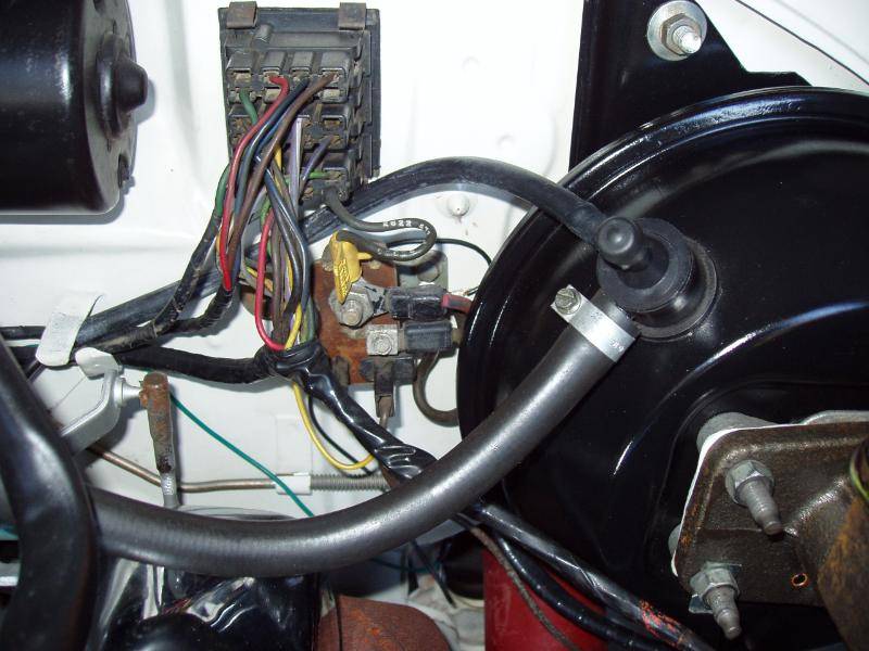

Haven’t been back to the hot garage but that’s basically what I thought I saw on mine. Fran, the insulation pin is there on my white car, it just got sprayed white when the last owner painted it.

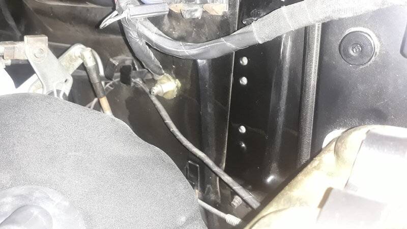

What was used to plug off the holes for the starter relay on the firewall when it was relocated to the left fender area on 66 Hemis - screws, rubber plugs, dum-dum?? Here is a picture of my 67 showing the general area where the relay is mounted on other-than-hemi cars, although I think in 67 it was shifted over to the outside to clear the valve covers. View attachment 1146736

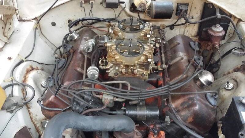

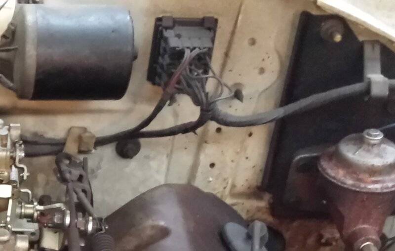

Here's mine - unmolested St. Louis car. Second pic is a zoom in from the first.

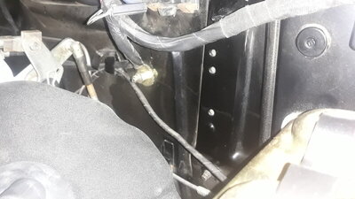

Checked for punched holes yes they were there guess I'm not that observant.
Yes, mine are punched through. Think I’ll put a dab of dum dum on the rear side while I have access so that no water gets in there.
