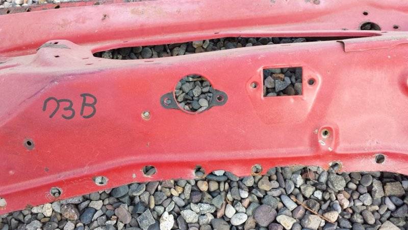

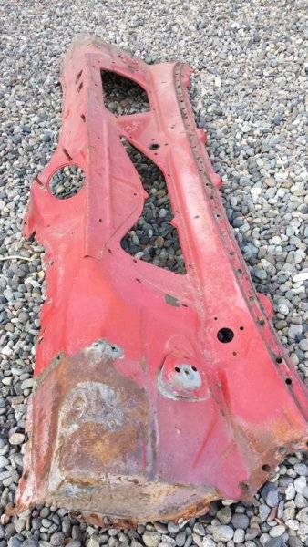

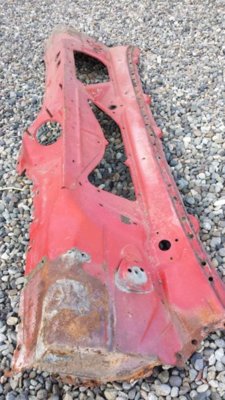

73 and 74s are the same, found a 73 RR for parts, the only thing I can see different is the outside skin.
On the top cowls, early 71 doesn't have the drains on the sides under the fenders. Mid-71 to 74 are the same except 73 has holes for the NOX valves.
I don't any available right now. I do have some fire walls.

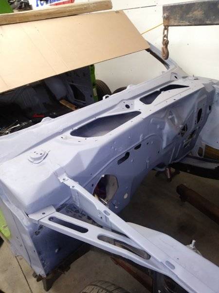

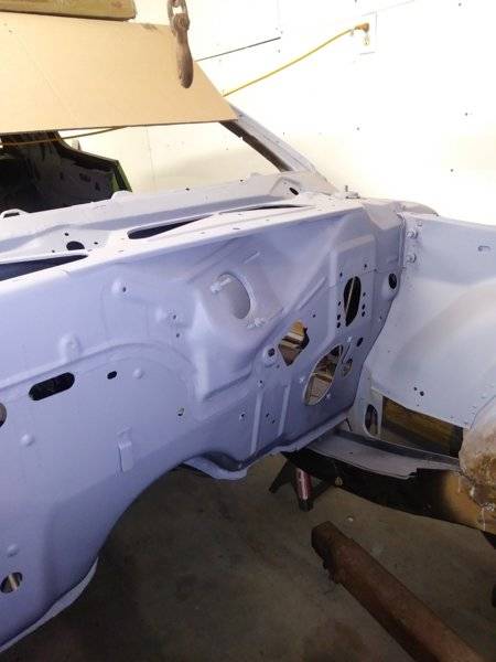

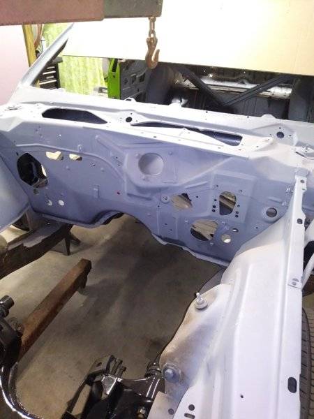

I hacked up a new Goodmark Ebody cowl & grafted it to my 71 n the bad areas along the firewall & along the entire wondshield channel. I also installed a new Goodmark Ebody AC firewall. I had tp slice the ends and persuade it into the upper corners under the cowl. & around the windshield channel area...
