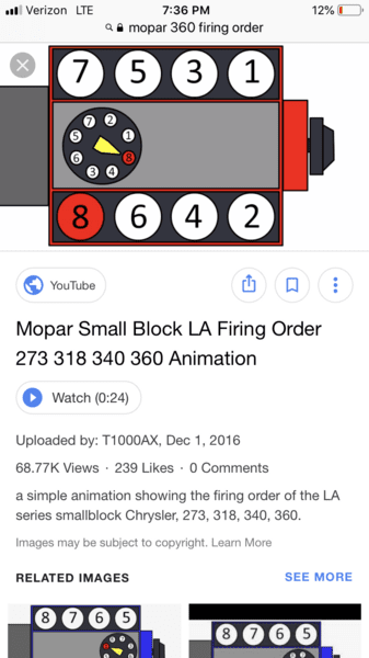

If my #1 piston is sitting at tdc and unlike this picture, my distributor pointer is pointing straight back to the firewall. Is that where I put plug wire #1 ? Then follow the firing order sequence ? I believe so, I just want to make sure because my distributor pointer doesn’t point toward cylinder two , like it does in this picture.
Sure you are not off by 180 degrees?
2 crankshaft revolutions / 1 distributor rotation
You may be on the top of the exhaust stroke, not the compression stroke.

Correct. The direction the rotor is pointing is irrelevant (assuming that #1 is at TDC on the compression stroke. as long as the #1 plug wire is in that tower.
Install the distributor correctly and get things to line up.
that's the first time I've heard someone say that and your right. I've never actually looked at the wire routing to see if there may be better options other than pointing at #1 cylinder.
Here's a useless fact. The "suggested" position of the rotor allows for the uniform production each individual spark plug wire length.

Useless, it is. Cylinders 1 and 2 are the longest wires. For the pointer to be pointed toward the front as suggested. Is defeating that purpose.
now that I look at the position it makes sense, you could technically make the wires shorter if you ran them as the crow flies in the position with #1 tower pointed at #1 cylinder. 1,4,3,2 are clocked to the front!
YOU ARE ON THE RITE TRACK. TO VERIFY YOU ARE AT TDC #1.. BOTH INTAKE AND EXHAUST VALVES SHOULD BE CLOSED
