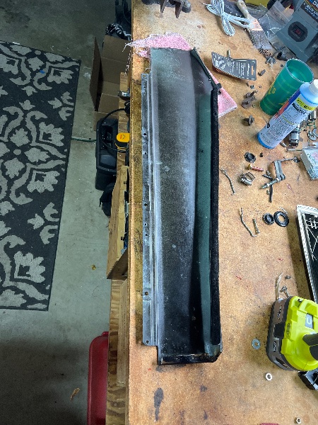

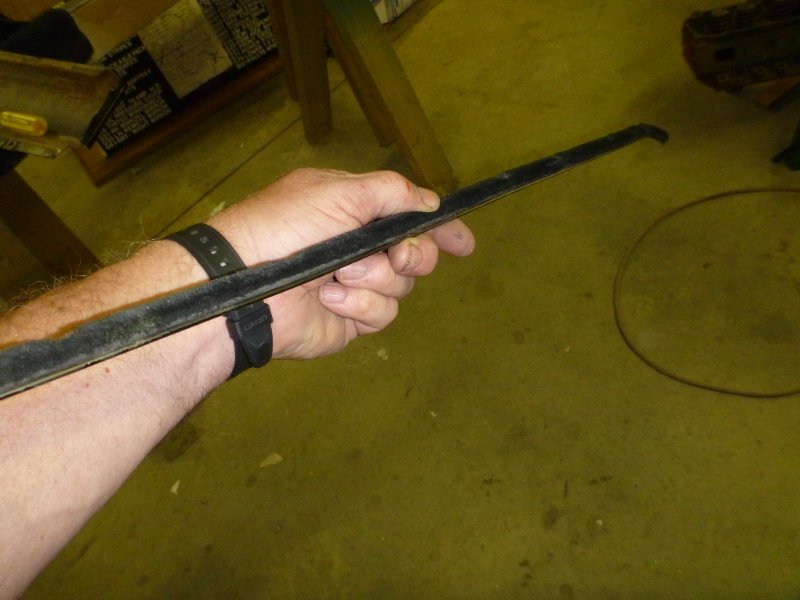

Hi All,

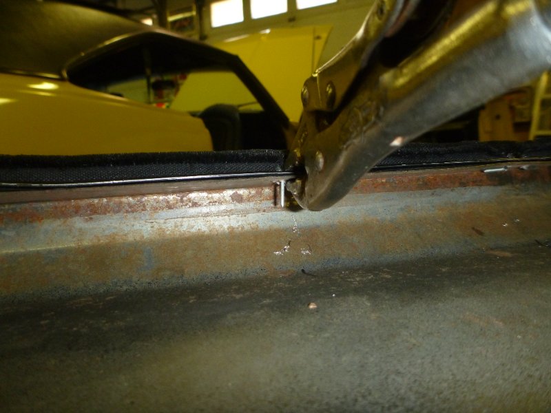

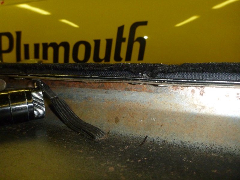

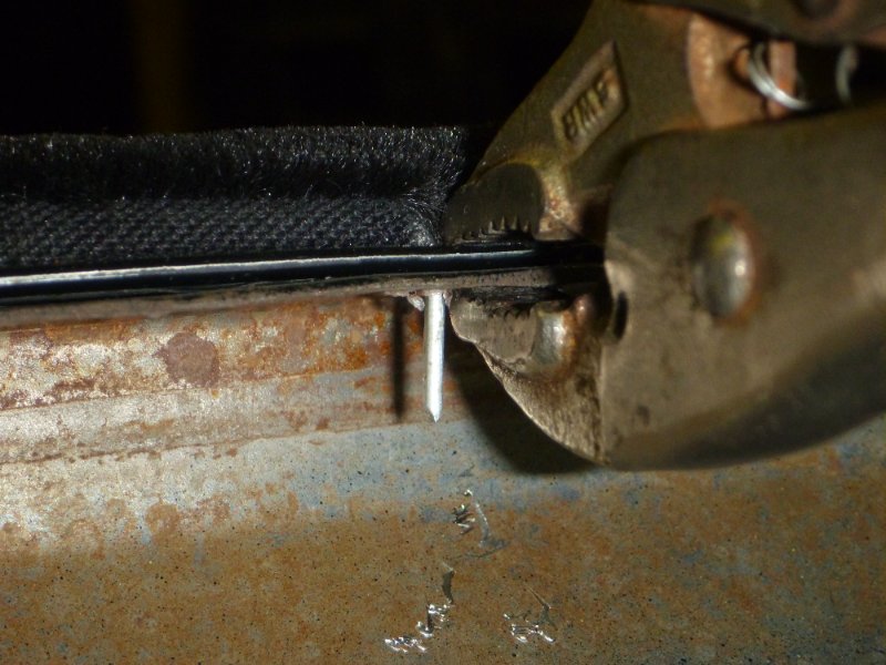

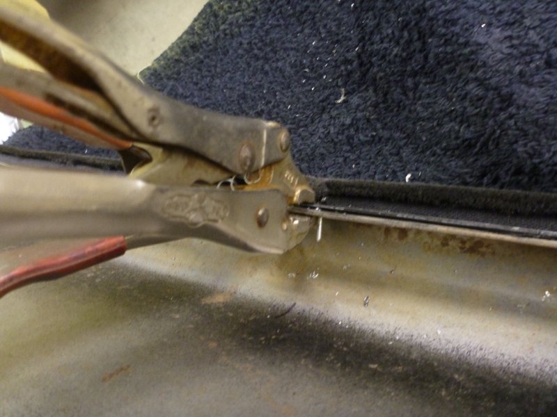

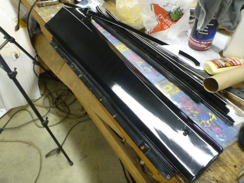

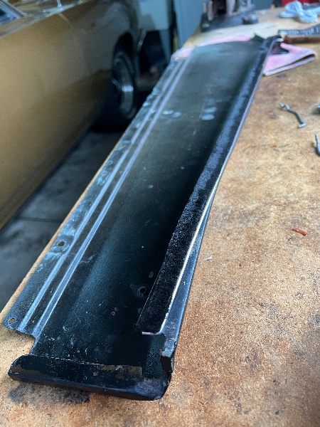

A set of inner and outer core window weatherstripping came in the parts box that came with our 69B. My question is is the profile of the cat whisker in the picture correct? The inner metal panel curves upward slightly towards the door, but the cat whiskers on both sides are straight. Is it supposed to be this way? Pics below.
Thanks,
Mikey
So the correct ones are curved, correct? Any suggestions on where to buy them?
Thanks,
Mikey.
They’re not curved, you have to put the first two screws in place so that it’s straight and push it down as you go. Start at the end on the front. That’s the best way I can explain it. Hope this helps
