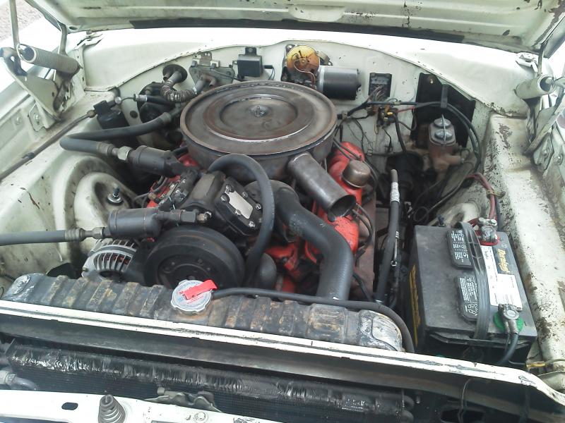

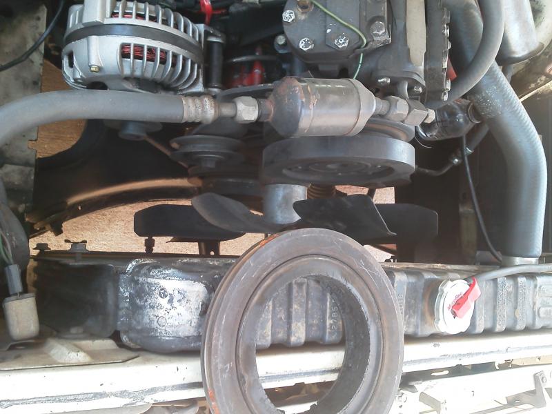

Here is the ac portion of my pulley separated. The car is a 4dr Belvedere II, Its a really nice survivor. l IMG_20140717_121953.jpgIMG_20140715_161426.jpgIMG_20140709_141657.jpgIMG_20140709_141650.jpgIMG_20140709_141634.jpg
What motor does your car have? Do you need the pulley that mounts on the A/C compressor or the crankshaft? Like was said, pictures will help us help you. Also, it's worth a call to BPE once you can send them a picture too.
Sorry its a 318
Very nice car. Congratulations! It appears that the A/C pulley you are referring to is actually a part of the vibration damper on the front of the crankshaft, that carries the A/C belt. Is that right, or are my old eyes deceiving me? A side view of that 'pulley' would help.
yeah, I think you got it, what it looks like to my older eyes !
Yes. the pulley itself on the ac belt groove is (was) suspended in rubber and vulcanized to the pulley, i presume to help in damping. but there is a balancer inboard from the pulley and this is at the most outboard end. is there another non damped pulley i can use?
You've got older eyes than me? I'm shocked...lol
I think I would take these pictures to a salvage yard near you and see if they can help you. They also have Hollander manuals that will show any interchangeable pulleys. BPE is still worth an email with pictures.
