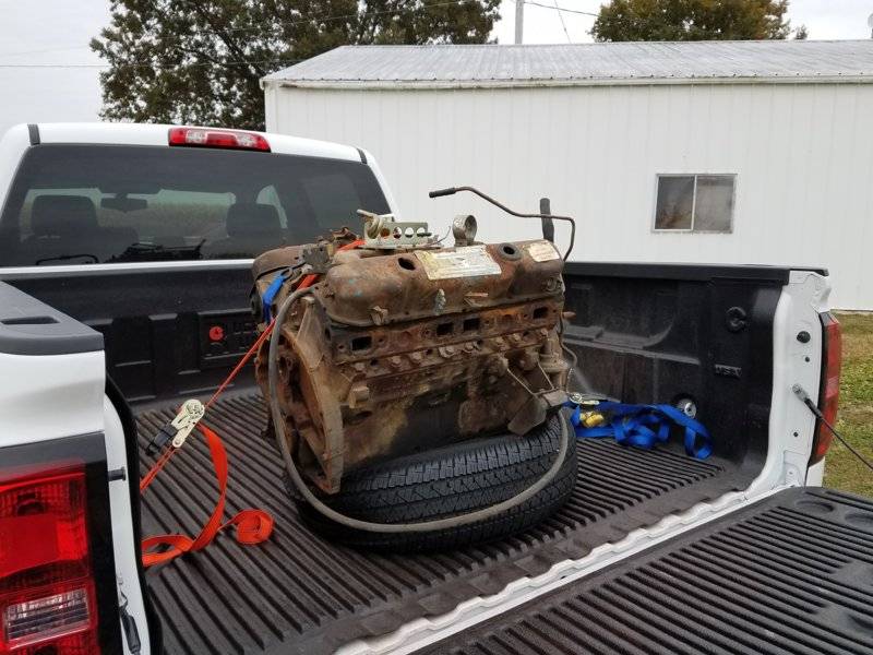

So here we go - I do not have the car yet, but she's out there waiting on me! I acquired this 440 (Casting #3698830*440*6)
She was cast on 07/02/1979 on Day Shift approximately 11:00 AM if I am reading the casting information correctly. I purchased this through a craigslist add for approximately $200. I spoke with the seller several time looking for a specific casting numbers (i.e. 1975 - End of Production). This one fit the bill. The seller stated the engine was salvaged from a motor home that was running before it was removed. She sat in a barn for decades and apparently served as a donor engine for the seller's demo derby hobby. Note the lack of exhaust manifolds and spark plugs - more on that later!

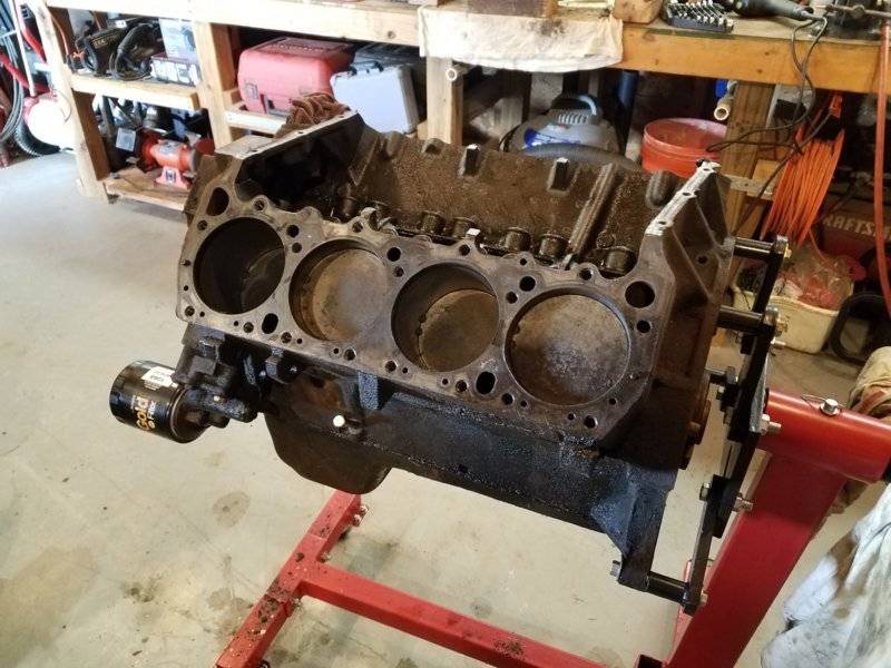

Here she is on the stand with the intake manifold, cooling pump assy, valley pan and 902 heads off of her. She had pistons #1,#2 & #8 rusted to the cylinder walls. After some research, lots of various lubricants and patience, gently eased her lose so she could make full 360 degree rotations once again! My assessment was since the spark plugs were scavenged from the engine, moisture was allowed to infiltrate, thus rusting the cylinders. Nonetheless she's free!
I used my calipers and established her bore's are all 4.320" (She's Factree - Big Vice Grip Garage Fan!!) and possibly a low mileage engine since I could still see crosshatch in her cylinders and there were no witness marks that I could feel with the "ol Mark-1" fingernail at the tops of her cylinders. All positive discoveries so far! I'm hoping my luck holds out with this $200 purchase!

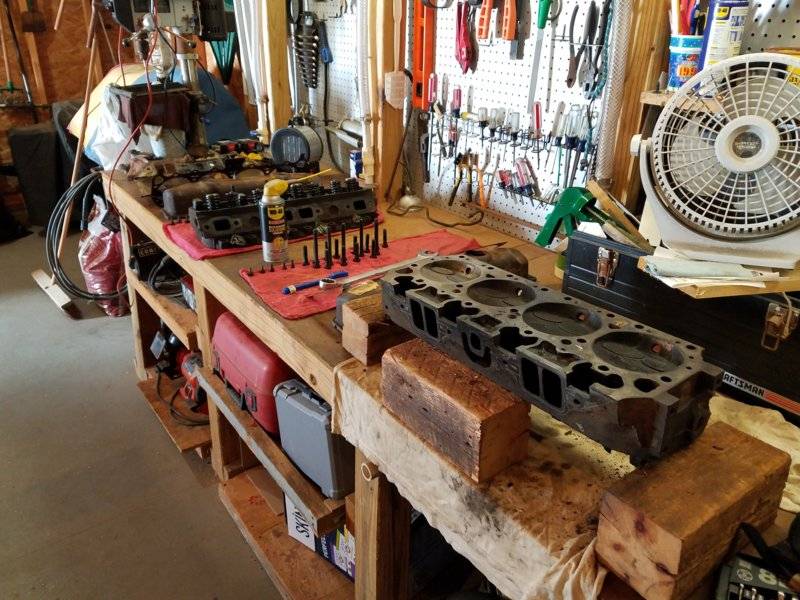

All of my books, guides, and research to this point has guided me to methodically document and organize the disassembly process. As a result, as soon as a part comes off, i take pictures, put fasteners in baggies with labels, and catalog & box the assembly with ample amounts of WD-40 applied. Below is a picture of the 902 open chamber heads (Castng #3769902) I am currently working on.
My intent is "CC-ing" the combustion chambers so I can begin to calculate my Combustion Ratio - my Goal is 10.0 to 1 on pump gas. I hope my 902's can get me there, but I'm not too sure! I have a lot to learn since I'm a first timer. More on that with later threads!
