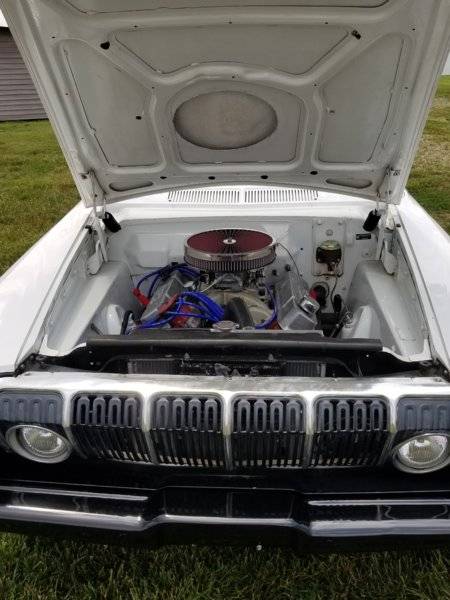

A 440 is a great place to start. You will be very happy with the finished product.
Thank you Ironbuit!
That's what I'm shoot-n for right there in your picture! What an absolute beautiful engine bay! Congratulations on such an clean and streamlined look: and a kick-butt car to boot!

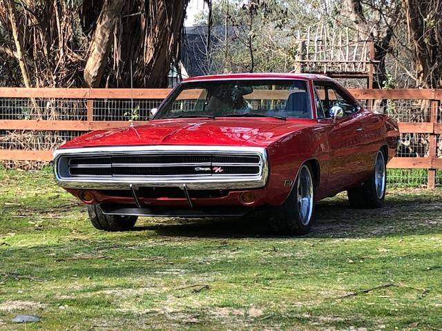

I bought it just for fun. I already have a finished one but figured I could build this one with parts saved from the first car.
WOW!
Your car is amazing! Thank you very much for taking the time to provide me with some very helpful information! And, a big thank you to all the folks who have taken the time to welcome me aboard!
