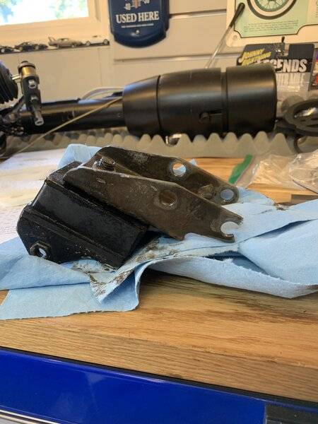

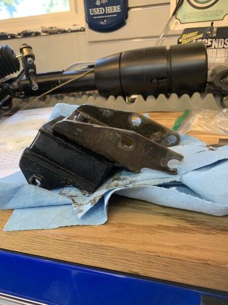

Fixable, or just replace the side, and all the rubber?
71SandbugCharger
6:23 PM
Jun 5, 2012
1,137
1,734
California
Can a weld shop fix this to be as strong as it should be? Or, just buy one side? I wonder how it got this way…
Thanks
085ADE74-09DD-435B-8171-44D1406AAEEB.jpeg 11A08B1A-EF01-4F83-9CC8-13E330C4704A.jpeg
I am not an expert welder by any stretch but a proper repair on that will be as strong as original. I've welded spring perches, subframe connectors, torque boxes, transmission crossmembers, frame rails and have never had a failure.
Weld a steel washer (same hole id) on the outside,
with some tack welds 'til it's filled in around the
outside. Then grind flat.
Make sure metal is clean and shiny. Easy Peasy
Done this a few times working on 80 year old
hard to find parts.
MoparLeo
Ordinary I would agree with your suggestion.
Kern Dog and I both lean towards fixing it in
a method that will make the part just as strong,
if not stronger than the factory part. A .35 cent
washer and 30 minutes beats $25.00 and 4 days
shipping.
hard to find parts.
Where can you find a good old American made flat washer (good alloy)?
Mike
Mike
Fastenal, Ace Hdw....etc. Could also use a piece
of 12-14 ga steel. A washer with any finish, like
zinc, would need to be sanded off. A grade 5
would work good for this fix, as it will be stronger
than the base metal, and wouldn't tear out again.
Oh, wait a moment on that.
Factory American steel with a repair versus Chinese steel on the new part ???
