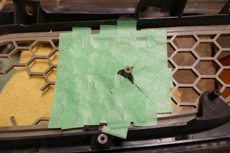

You can see here that a hole is in the hexagon grill, that piece was missing when I got the van so I didn't have it available to glue back in. So instead, I'll have to recreate it. The plan was to make a mould of the pattern in the good area and then move the mould over to fill with Plastex and repair the missing part.
This is the back side, the grill insert has a flat back so taping it up was easy.

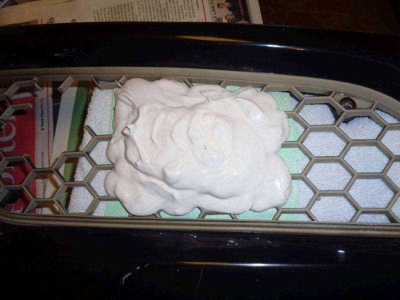

My first thought was that I could use a plaster based moulding compound, similar to Plaster of Paris but much stronger and specifically made for moulds. I sealed the bottom with tape and made my mould. I had read that coating the plastic with dish detergent would enable it to freely separate after curing. It didn't work out. After it had hardened, I found that it was firmly stuck to my grill and couldn't be detached at all. I ended up chiselling it off in small chunks and had to sand the remainder from the plastic. Its possible that if I had used a PVA mould release it would have separated, but I thought I'd try a different approach.

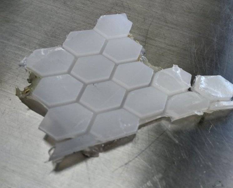

Next attempt was to make a silicone mould. Using two part silicone made for moulding, I again taped up the bottom and also made a dam to keep the liquid in place as it hardened. This took all day, it was at least an eight hour cure but I let it go for 24 hours to be sure before seeing if it would release. And it worked, peeling away easily, not sticking at all like the plaster did.
You can see that the impression is a perfect mirror image of the original part. So after a bit of trimming with scissors to better fit the edges, I put it in place, firmly backed with a piece of plywood to prevent it from sagging. Had I known better, I would have put a plywood backing right into the liquid silicone and let it harden in place to retain the original curvature of the grill; this stuff is fairly floppy and wants to sag easily without reinforcement.
