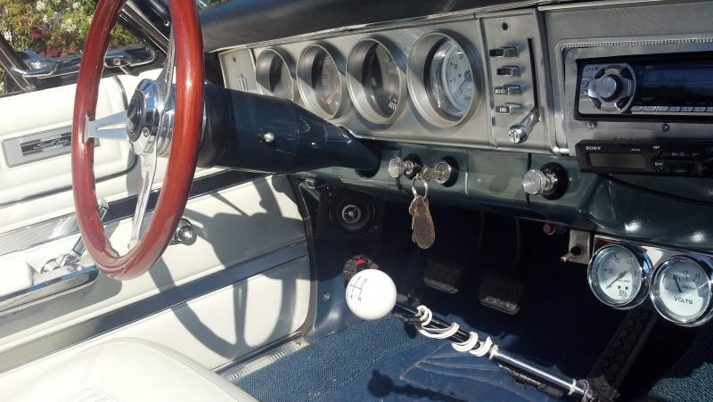

I purchased one of their stainless columns for my 64 Sportfury from Summit Racing back in 2008. I purchased FR 20006CP which is the 33" long 2" diameter column. I had it painted after I mocked it in. Everything installed well and I still like the quality. I don't know if engine choice makes a difference but I have a gen II crate hemi in mine. Hope this helps.
