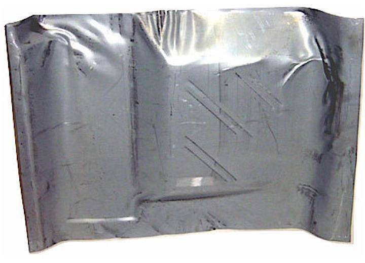

Check with Jim Kramer. I heard that he was going to do another run of one-piece front floors. I think he bought AMD tooling. Sherman's in Detroit makes replacement separate left and right floor panels without the transmission hump.

I found the ones from Sherman’s. It looks pretty bad in the picture.
