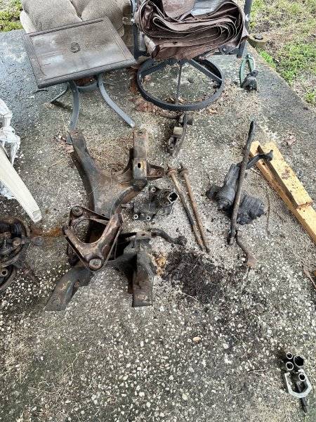

With a significant amount of heat and one last round of persuasion with a mini sledge the passenger LCA is now off. Definitely had corrosion in the socket binding it up. While I as feeling motivated, I also pulled the torsion bars and dash harness. It's in pretty good shape, but I have a new replacement one. At some point I will re-home a lot of these parts here on the forum, but I want to get the car running first.

I did discover that my car was not equipped with a sway bar during all of this. That is yet another setback. I definitely want one as I plan on "driving the piss out of this car", to put it politely. Took advantage of the Jegs 4th of July sale and got the weld on LCA sway bar mounting tabs, and the Jegs sway bar kit. Also realized my poly front end kit did not include the strut rod bushings, so I am getting those on order too.
Still haven't got the last LCA off on the passenger side, but I am planning on going maximum-attack on that tomorrow now everything is out of the way. Here's hoping I can get that freed up and get those torsion bars out as well. Really hoping I succeed without having to resort to cutting. Fingers crossed, and happy 4th!
If it didn't have the mounting tabs, then it came with the earlier clamp on swaybar. Someone removed it
Hm interesting, so all Chargers had a front sway bar from the factory? The red charger had the earlier clamp on style one in place still, so I did get to see what one of those looked like. I wasn't super thrilled with that design, is it possible to adapt to a later style one? I see they sell a weld-on tab kit for the LCA to add end link mounting points.

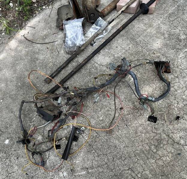

Boot the old harness but keep the molded connectors. You may need them down the road.

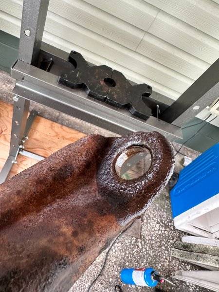

More progress over the weekend. Pretty much no one in my area will press out bushings apparently, kind of a crazy gap in the market that I never expected to be an issue. The largest machine shop in town, who I've worked with several times for cylinder head work, apparently used to be the only game in town and all the smaller shops and individuals just subbed out to them. Figured since I not only needed to do the bushings on the Charger, but also on my XJR, it would cost a lot less to just buy a big press and do them myself.

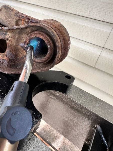

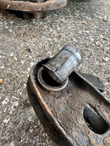

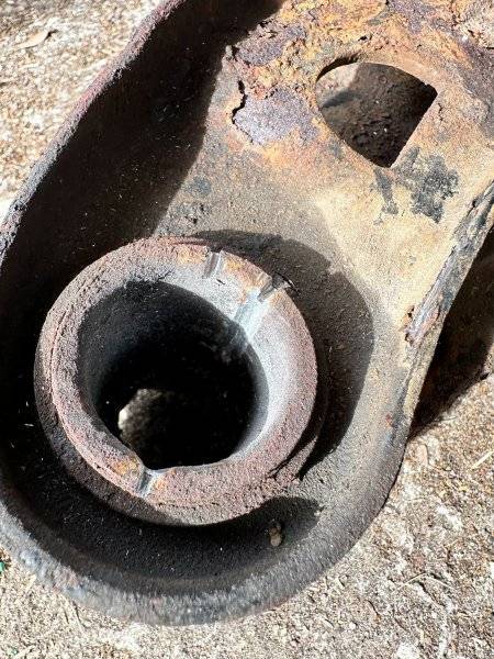

For the notorious LCA bushings, I pressed out the central pins, then pried out the rubber with a screwdriver. I did not have ready access to a welder for the "weld on a big washer" method, so I took a different approach. I used a Dremel and a burr bit to score the inside of the outer bushing sleeve. I went as slow and careful as possible to minimize scoring to the inner mating surface. I also notched the flared top to complete the new "Split" in the bushing.
I then applied a lot of heat with a blowtorch, and proceeded to use a hammer and chisel to curl the sleeve in on itself. Didn't take much curl to free up the sleeve, and I was able to pry it up then wiggle it out with pliers. Was it a fun job? No. But it was not as bad as I had imagined after reading online. After that, getting the upper control arm bushings out was easy thanks to the big press.
Now I just need to get the balljoints out of the uppers, and I need to weld on the later style sway bar mounting tabs for the lowers. Can't wait to get these out for powder coat!

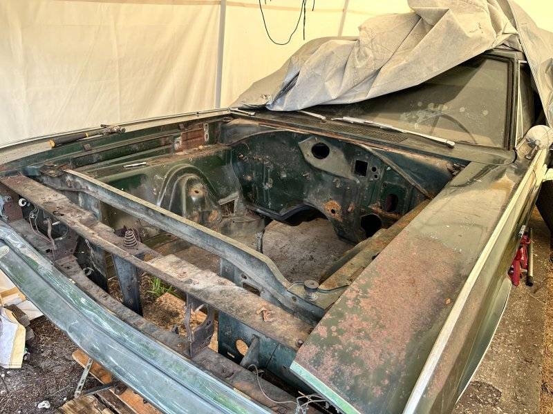

Someone needs to make it cooler here in FL, I swear. Anyway more updates! I pulled the hood off the car, as well as the hood hinges. Tons of fun doing that on your own! Incredible timing though, I found out that my new fiberglass six pack scoop hood was complete and ready to roll!

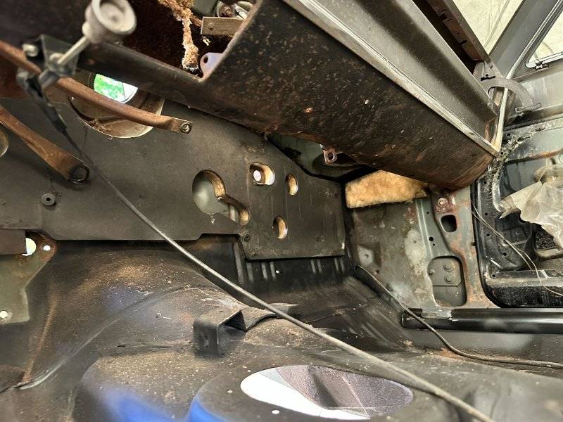

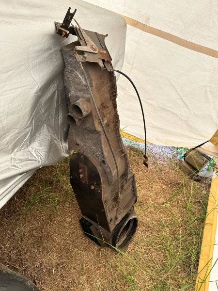

I also had a blast pulling the heater box out from under the dash. It was relatively straightforward, but doing this in a 95 degree tent with zero breeze makes everything that little bit more challenging.

The firewall pad seems to be in really good shape so that is a plus at least! I plan on rebuilding and repainting the heater box before it goes back in, but that is lower priority for now.

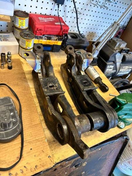

I also had my welders add the 67 style swaybar tabs to my LCAs. The tabs I got were made by Hotchkiss and seem to be really well made. They did a good job welding them on to the arms too, all in all, happy with the result and now legitimately ready to drop stuff off to powder coat tomorrow.

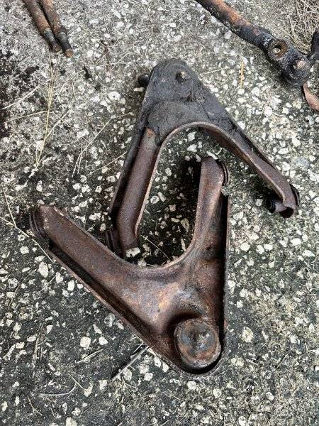

I ended up purchasing a new set up upper control arms and upper engine mounts, as the old ones were not really playing ball. Not wildly expensive, so the money vs. time element made sense. Also less stuff to send off to powder coat! I spent a few hours beginning the process of wire wheeling and sanding the engine bay in prep for paint. I hit it with a little rust neutralizer just to seal it and prevent more rust from forming until I can get back on it this weekend. It also helps seeing it in a solid color, as the minor imperfections are easier to identify. I might even do a little smoothing, that has yet to be determined though.
My future now holds several days more sanding and prepping, but I am feeling good that the engine pay is going to look great once the epoxy primer and green paint get laid in there.

I would suggest checking the bushings on the new upper control arms.
Make sure they are a press fit and won't spin in there once you've installed everything.
They aren't as good quality as the originals but then again they don't have to do much.
The good news is, I will ironically be replacing the brand new bushings when they get here. I have a set of poly ones on the shelf. Will definitely allow me to inspect them thoroughly during the process.

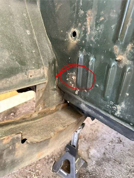

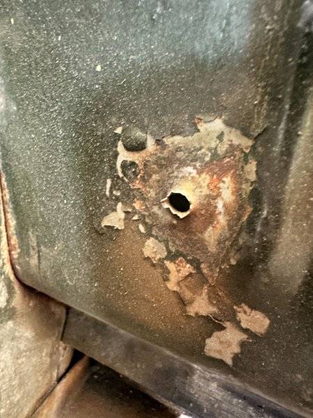

Random update, found what I am 90% certain is a BULLET HOLE!? It comes from the passenger footwell into the engine bay... Someone goofed up and had a bad day. :lol:
I have an antenna cable hole on the rh side cowl that looks like that.
Most I have seen are in kick panel . If that was a bullet hole, a person could align the angle of path and see were it should have carried on I think.
I did have a Charger that had a bullet hole through a fender.
Eyeballing it, looks to point right toward where someone's lap would be in the car, and the outward trajectory puts it right through the rectangular opening where the brake line would pass through.
For a separate antenna, or stock? Mine has the stock antenna cable routed the regular way independent of this hole.
Stock antenna to the best of my knowledge.
This is on my 65 Coronet. It looks like it was punched like yours. One of a few more that will get capped off.

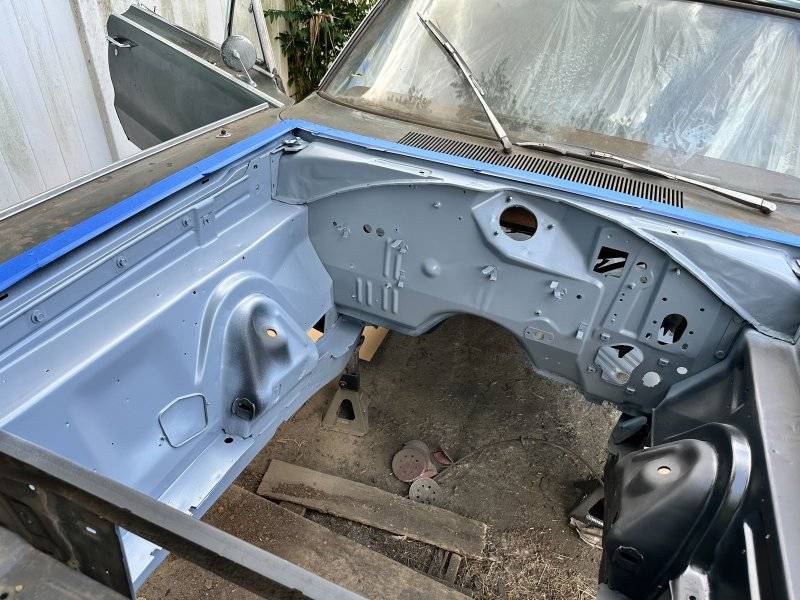

More progress last weekend, forgot to post here with pics so time for a little catch up! I got the whole floor pan epoxy primed, and got about half way through the engine bay. Unfortunately the spray gun started being a jerk and I couldn't get it to behave before I started getting a lil "heat strokey" out in the sun.
I spent some time yesterday doing a good amount of sanding in preparation for tomorrow morning. I'll be getting out there early and finishing the epoxy. After that, Sunday morning early I will be out there doing the color coat in good ol GG-1 green! Nervous as hell for that one, but I have some speed shapes to practice on before pointing the spray gun at the car. I am not going for "100k resto" quality, but hopefully as nice or a bit nicer than factory.
