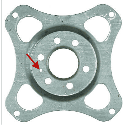

Does the torque convertor have a drain plug?
If it does it goes 180 degrees from the 3/16 hole drilled in the flex plate...
