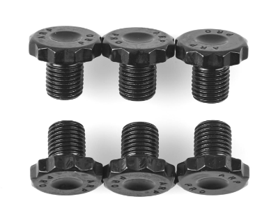

What do the bolts look like that connect the flexplate to the crank? THe ARP ones (The Official ARP Web Site | Kits), look like a star head? Is that right (pic below)?

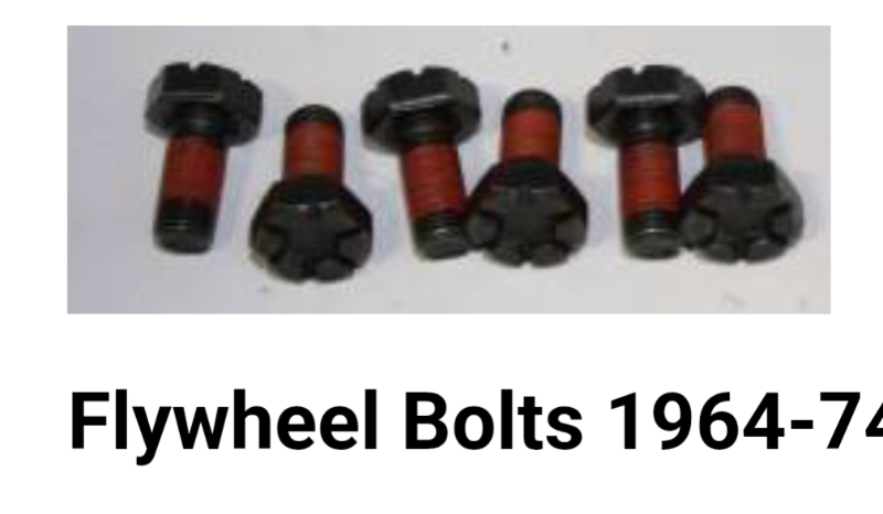

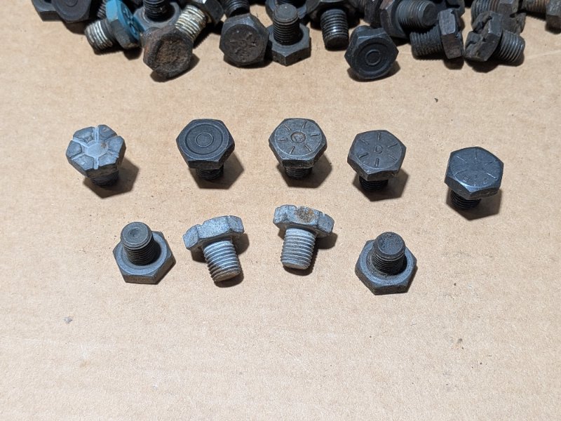

There were a few different head marking styles used on the flex plates to crankshaft bolts, but they are interchangeable. The following images shows the bolts and different head markings:
That's what the ARP bolts look like exactly.
Those ARP's are 12 point bolts. No problem. We all have 12 point sockets.
I think you are concerned about the "star head". It is actually a 12 point bolt they work great and work perfectly with a 12 point socket. I bet you already have the socket. :thumbsup::thumbsup:
