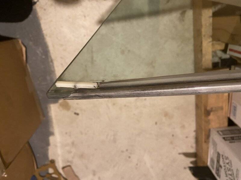

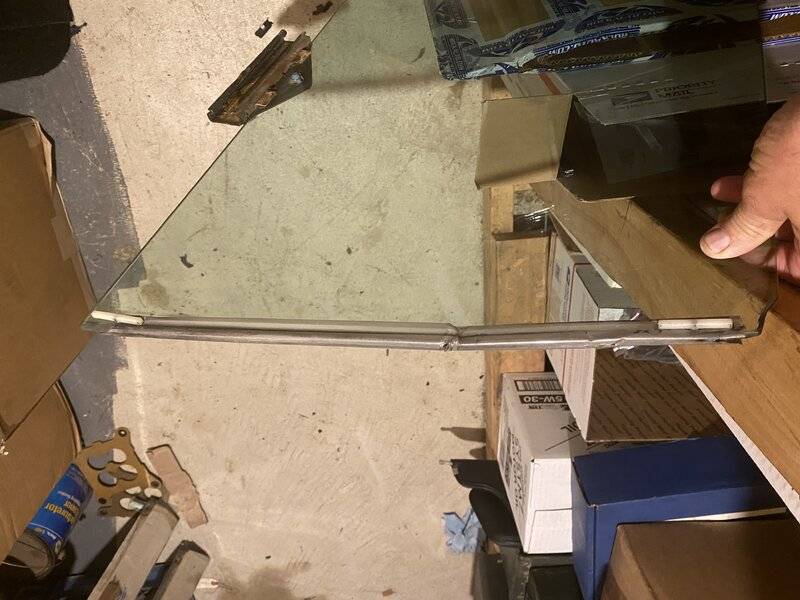

Thanks but those aren’t what I was referring to, here’s a photo
DF8B9E1E-ACB7-44F9-9DE2-97F807B0B8BF.jpeg 822A925C-DABE-4DC2-A51D-A573C90CC1BA.jpeg
Those acetal sliders look good to me.. and you'll want to reuse them if they are!
I'm just amazed at how many of these posts there are that nobody reads.. LOL
I took a picture of the better glass, other glass half of one is missing and has no plastic sleeve at all.
We're talking two different things... the white acetal sliders and steel pin that joins them. If they aren't cracked, reuse them...
we are talking about the same thing, one slider is broken off the other glass

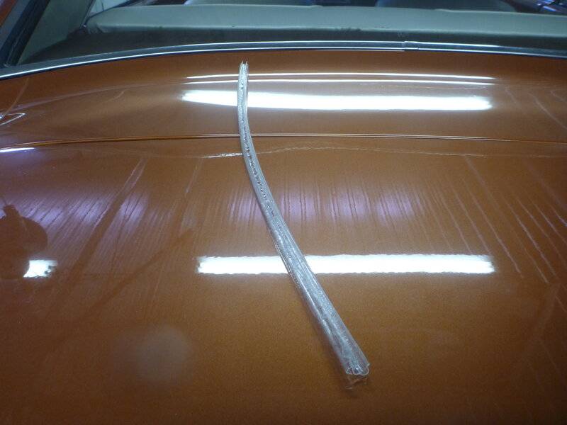

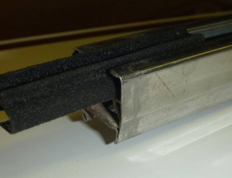

You're welcome to try forming the flocked mylar in their correct curve. I spent months on it, but can't source material thin enough to work 100% and have given up until the supply chain recoops. As for the "H" slider/pin combo. Simple injection mould and a bag of Delrin. That's the easy part for me, as I co-own an injection moulding company, but no point without the mylar..

Hey, what thickness of Mylar plastic are those channel "sleeves" anyway? Found a company that has Mylar plastic in sheets but I need to know what thickness the film needs to be.......the flocking can be worked out after I get my hands on the sheeting and figure a way to form it correctly.

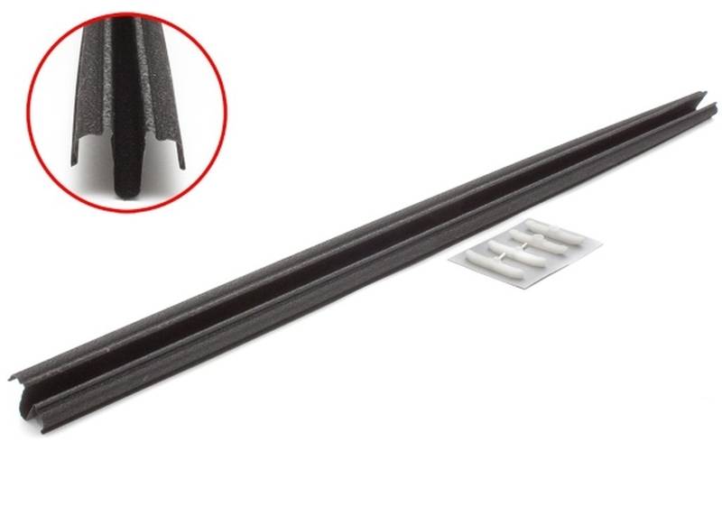

Are these not what everyone is looking for?
I measured it at .010, ten thousand of an inch
