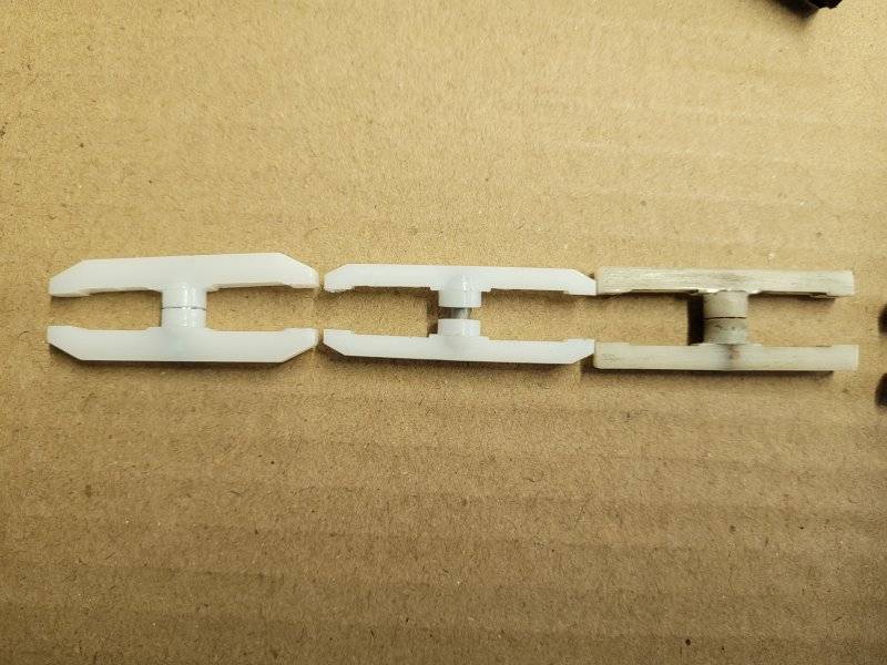

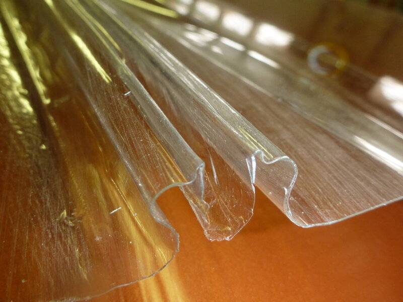

Yep... but the real million dollar question is what thickness and material type do you need to start with for a successful vacuum forming to end up at the correct thickness?? and can you obtain said thickness of raw material? Like I said above I spent a few months on it and well over two thousand dollars.... and have 36 years experience in the plastics industry.I measured it at .010, ten thousand of an inch
