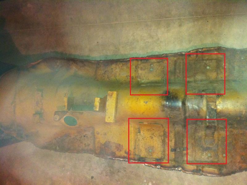

Floorboards are all the same from buckets to bench. Bucket seats had plates welded in on the interior for reinforcement, and the plates are available through AMD if you want an original look. As Tallhair says, you can make your own, but I would recommend welding them in so it distributes the load across a wider area. If you look at the inboard area of the floorpan, you will see dimples where the holes are drilled through.
As stated the pans are the same. Unlike the earlier B's and E-body, the 71-4B's have the plates inside on top of the pan instead of on the bottom side.
Moparmarks....aren't the 66-70 plates also on the inside on the top of the pan also, or are you refering to earlier than 66 B's. Attached is a photo of a floor pan section I have from a 69 car, and I have a 68 sport satellite with the same plates. Sorry for the poor cell phone photo...but it gets the point across.
Ya you are right and I'm getting old. The O' brain cell can only hold so much data.

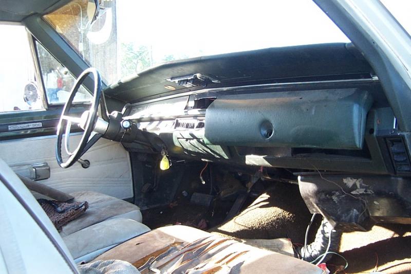

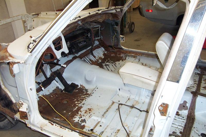

Moparmarks....is that a 4 door in your second picture with the buddy seat? Didn't know that ma mopar did that in 4 door cars. AC too....looks to be a well optioned car.
Ya that was a 68 Coronet 500 4-dr. 383, buckets w/ buddy seat.
Ya you are right and I'm getting old. The O' brain cell can only hold so much data LOL
Shiznit. Me too! Thanks for squaring that away dsd1967!
That's cool man. I've never seen an original 68-70 4 door anything with buckets that I can remember. Seen a few Station Dragons turned super bee or RR clones which I love btw tough so it definitely works as in look great. What are you doing this this one and if fixing what are the other details?
Guess this is the only shot of the buckets that I have. They are the same as 2-dr buckets and can be converted to flip forward. The tracks are about an 1" taller than 2-dr tracks.
