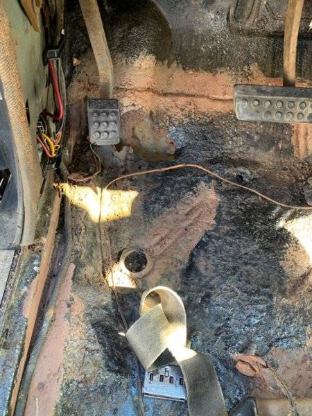

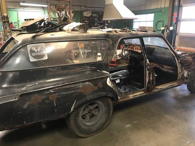

Well since my state has closed down all non-essential businesses I decided to rip out the interior of my wife's 65 Belvedere wagon. It's a mess. I need new floors. A lot of patchwork done in the past along with the usual New England rot. Where do you all get your floorpans from?

You could try AMD.. but they are discontinuing some of there 62-65 B-body sheetmetal, but
I was over to the Auto Body Specialties Website a few days ago, and did see they still had up on there website, the complete front floorpan, and some other stuff. You could check with them.. because they are in your neighborhood, in Middlefield, CT. Just google their information. I will have some oem ma mopar original floor sheetmetal at the Chryslers at Carlisle show in July. Hope this helps!

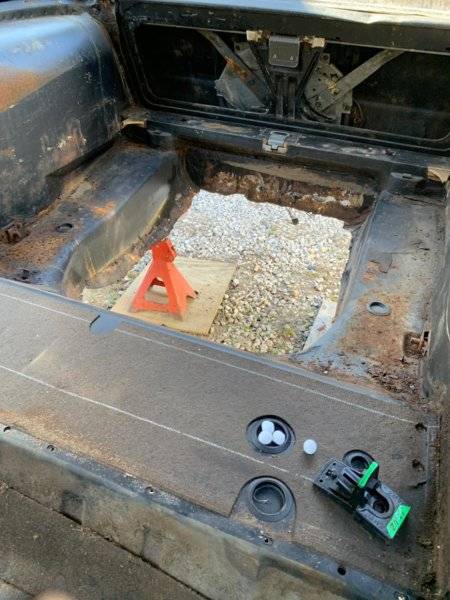

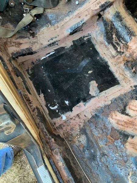

Here's the mess in a New England car. There's daylight under that spare tire well. I cut on out of a 66 Charger. I'll have to do some fabrication.

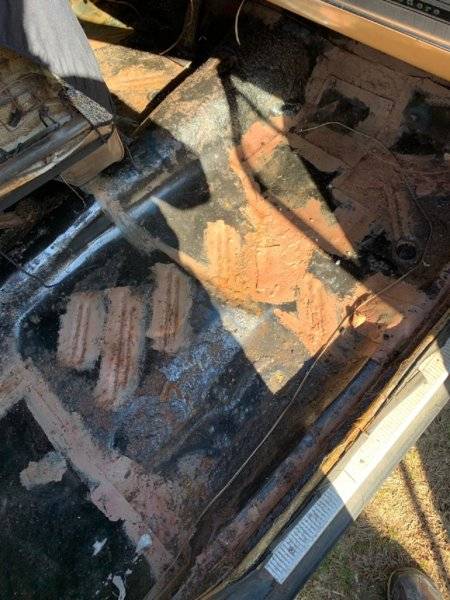

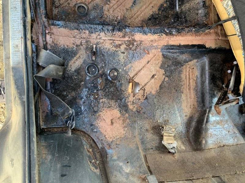

The patchwork floor from days past. I'm thinking I'll just get the whole pan and go from there.

Man, that's gnarly. It's photos like these that make me glad my car spent it's entire life in the arid climate of central Washington.

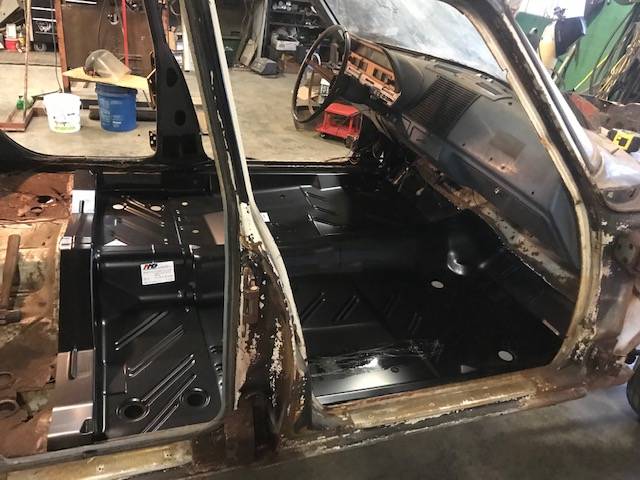

We just replaced the complete front and rear pans in a 63 wagon , pans came from Kramer the went in ok.
