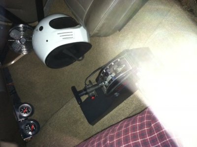

i'll go look on mine now and get back to you ASAP
I WOULDNT MOUNT THAT SHIFTER ON AN ANGLE. Mount it straight up.
Thanks SSR, I was questioning if it was too far back and would make the cable loop to tight? Thanks again.

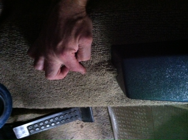

doesn't look too far back. hope these help, just straighten it up.
hope these help. top one is where my cable goes through.. About 4 inches from the front of my shifter console.

Does the cable loop underneath first come out from the floorboard in front of the cross member, and then pass under it on the drivers side? I will pay cash for pics underneath! :headbang:
I want to make sure I route the cable loop underneath correctly.

**** good question. We got one problem, my car is in the trailer all loaded up for Friday.
ok I remember loop it on passenger side over top of back of bellhousing and then to trans. mount bracket.
ill see if I can get under there tomorrow.
yes it goes in front of the crossmember IIRC.
