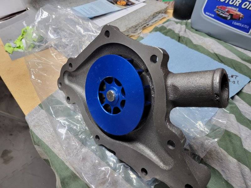

I used to buy the edelbrock pumps years ago, pre private equity involvement. They worked super well. At least 15 years ago and further on back. I had them on two different cars.
I’ve been intrigued by the Flowkooler design and was going to try one this time. Being 100 bucks cheaper was another reason to see it in action. The edelbrock is on sale now at summit and it’s down to 80 bucks spread.
The edelbrock still says made in USA. From what I’ve read, the Flowkooler is a Chinese gmb pump with an American made impeller. Or it could be American designed is all. I suppose for me it comes down to whether the edelbrocks are still a quality piece.

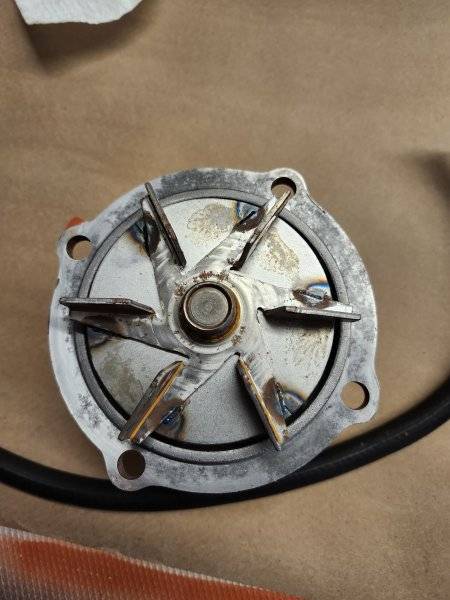

I've had problems with the edelbrock impeller design (440 source is the same) increasing temps. I've found that the 6 large impeller design with an anti- cavitation plate to work about as good as anything and the edelbrock design the worse.
Interesting, do you happen to remember which design stat you ran with it? Mine held right to whatever temp I put in, per the mechanical gauge.

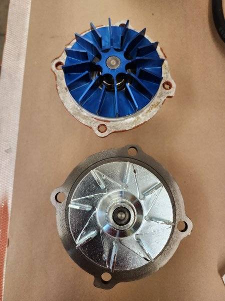

I've had good results with the Milodon 6 blade pump with anti-cavitation plate. For fun I also tried a Flowkooler pump and it's in the car now. Both work well to cool my big block at speed and for short duration (less than 5 min) idle in traffic, but the Flowkooler pump reduced my long duration (15 min+) idling in traffic temps by 10 degrees, which I've experienced during bad traffic jams on the interstate.

I used the 440 source which is an edelbrock clone. Temps were 10-15 degrees higher than a 6 blade anti- cavatation pump. I found no difference between flow cooler and the 6 blade pump. Of course there may be variables between engines/ radiator, etc. There is a conventional 8 blade pump with the anti- cabatation disc out there. I bought one a few weeks ago but haven't tried it.
I live where my summers are 125°+. I run a Flowkooler in a 496" stroker w a/c. Obviously water pump is only part of the equation, but it flows very well and when I had a 160° t-stat, it flowed enough at low rpm to keep engine below 180° w a/c going. 4yrs with it now and no leaks or issues. I have 3.73 gears n GV and frequently cruise interstate which is 75mph so I'm cruising 80 at 3,200 rpm for distance and get no cavitation either.

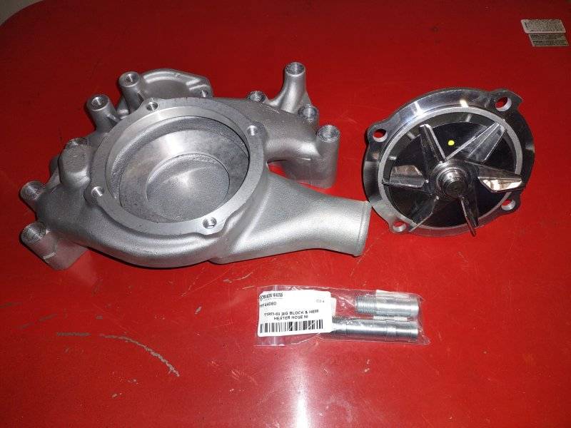

I bought the Mancini high flow pump and aluminum housing at Carlisle. It has the anti cavitation plate as well. it will be installed on the new 400.
