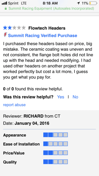

This about sums up what you can expect.
That's not the consensus I've been hearing.
I guess we'll see.
