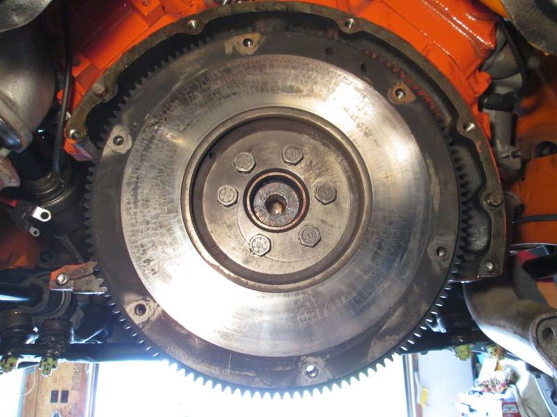

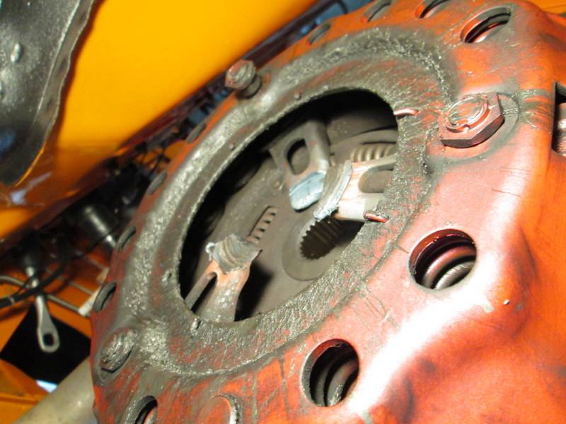

I had a failure in my driveline Friday night going to a Cruise. The pressure plate gave up, as one of the finger cast arms snapped, and that was all she wrote ! Ended up tearing things up a bit, so need to replace it all. After pulling it apart, I see there are stress cracks all around the circumference of the flywheel, and they are deep enough to feel the edge on them ? Is this a product of age, heat, or is it just time to replace it ? The car gave no indication of trouble, and it's not a high output design, just a 383 stock type build, and it really doesn't get beat on. Can the F/W be turned and re-used safely, or is a boat anchor ? Thanks for any input on this..

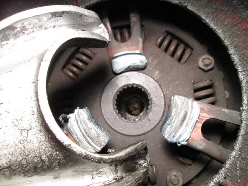

I've never seen the fingers of a pressure plate worn of like that. Either the clutch wasn't releasing fully or someone has been riding the clutch
Heat makes the flywheels crack. I would replace it.
Heat cracks are normal where the clutch has been generating some heat and they start at the surface and work into the flywheel... I agree with the clutch breakage too. That looks abnormal to me.
It can be turned, but you want to make sure none of the cracks remain. I've done that several times before with the engines being beaten pretty hard. So if there are any signs of cracks remaining after it's turned, get a new one.
I would also dial indicate and center the bellhousing too. That may be causing some issues.
They may machine out - just depends how deep they go. You might take it to a qualified machine shop that surfaces flywheels and get their opinion before spending money on it. Also you may want to measure the thickness of the flywheel as it may have been turned once or twice already and could be on the thin side.

Get machine shop to check if flywheel is worth turning. Many times the normal small surface heat cracks you see can be cleaned up with resurfacing. If you can get a fingernail into any of the larger cracks they will not turn out. Looks like no toe play causing throw out bearing to run on pressure plate fingers all the time until throw out bearing finally failed. See a lot of this failure in autos and commercial trucks with push type clutches.
Fingers wore as a result of no clearance to the throw out bearing. The bearing then turns constantly, something it's not designed to do. Is the face of the T/O bearing blue? What does the front bearing retainer look like where the bearing rides? More pictures would be helpful. I agree that I'd let the machine shop dictate the suitability of using that flywheel. For non high performance use, a new stock flywheel, clutch and pressure plate is all that's needed. Don't forget the pilot bushing and T/O bearing as well.

I agree, throw out bearing failure or improper adjustment. Call Brewers, get the right stuff including the release fork. (the ends look a little boogered up) Take the flywheel to a machine shop. They will know if it can be saved. Hopefully they can grind it and not turn it on a lathe. Grinding gives it a better non-directional finish. I had a new clutch fail like that from improper adjustment. I adjusted the free play and not the gap between the t/o bearing and the pressure plate fingers. Since then, I adjust the gap and have had no failures. 1/8" works.

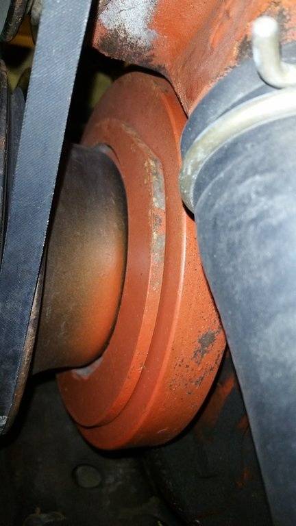

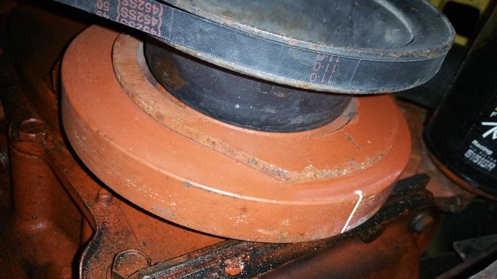

I have a 71 440 in my 70 V-code Roadrunner. It came that way. 6 bbl intake, 292* .509 Purple Stripe cam. The 2 pictures are of my harmonic balancer. It has the eccentric, which I'm told means externally balanced. I am sure it is a 71 block, I checked the date code. I have read and been told that 70 & 71 440x6bbl and 440x4bbl motors had steel cranks and "heavy" rods (I assume that means "6pak" rods). The picture of the flywheel by the O.P. looks like mine. I have never noticed in the couple of times I have held my flywheel in my hands any signs of balancing.
