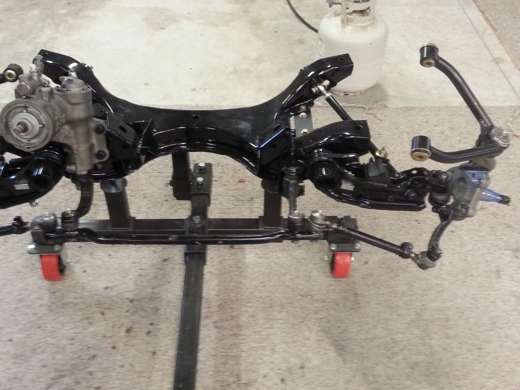

I have them and no complaints. Great customer service and Dick knows Mopars. Got UCA, they did my gear box, P/S pump, and got a K member stiffening kit from them. Call them and tell him what your intentions are for your car then make your decision
I have them and no complaints. Great customer service and Dick knows Mopars. Call them and tell him what your intentions are for your car then make your decision
Sharp looking K there. FMJ or B spindles on yours?
