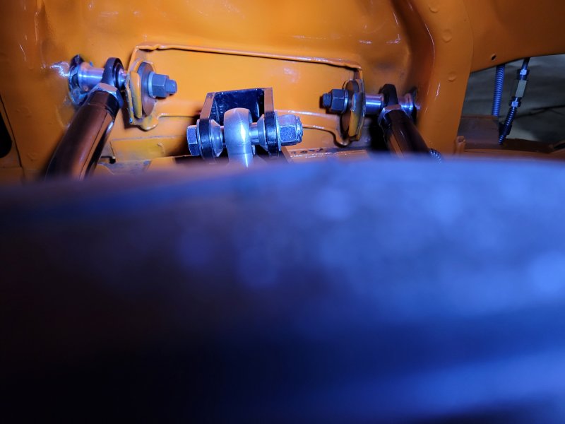

Here's mine, small spacer, large spacer each side, not both together. Now, you can alter things for caster if you can have someone make what you want. Not uncommon to have to stretch the control arm a little. Any cars dimensions can be off a little or from accident damage.
Thanks for taking the time to take a photo for me. I appreciate it. I’ve got a machining background and access to a lathe so it won’t be difficult for me to make up spacers like the ones on your car.
Tweaking and flexing them into place is an option but I can’t bring myself to alter them when I see something like this.
Not knowing what your measurements are, I'd at least make the small side 1/2 the length of the large side, so you can flip them if needed, and still be in the ballpark I would assume.

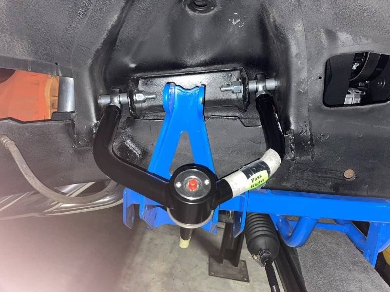

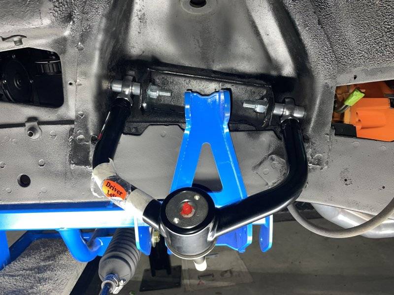

I’ll bust out the vernier and a gauge block set to get right down to the thousandth of inch if needed. Both driver side and passenger side look to have the exact same condition.

I’m going to have to call them again to follow up. I didn’t receive a response after being asked to email pictures of the issue.

This is what I would do. Measure the mounting tabs on both sides of the car. If they are the same the issue is the arm. If not? nobody has considered that posibility. Making spacers to allow an incorrecty shaped arm is the wrong repair in my eyes. Would it work? Yes. Unsupported tubing can be made to move quite easily. Moving one of the brackets on the frame would be far more difficult. The bottom line would be to have the right side ball joints and the left side balljoints in the same two planes. How do you do that? Hard to measure and easier said than done until it's on the alignment rack. Then there is the question. Are the two front rails exactly in the same planes? Probably not. Adjusting the upper ball joint so it rearward of the factory location will add positive caster. Moving it .100" is worth about a degree. QA1 may have already built this into the arm. Don't forget adding additional caster drops the outer tie rod. Outer tie rod height is critical to bump steer. But that's another discussion.

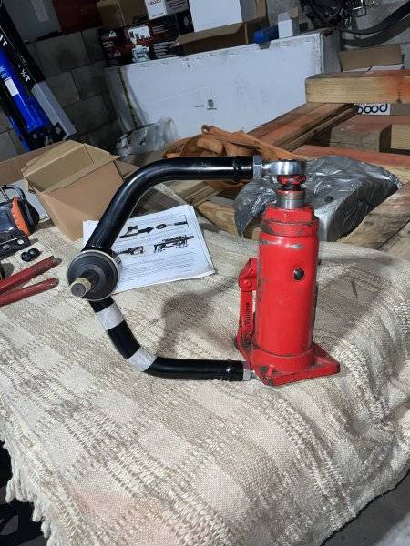

Decided to use a small bottle jack for a controlled, calculated spreading of the UCA. It spread quite easy just like gkent had said it would. I heard no creaking or cracking noises while doing it, so I feel good about how it turned out. Both driver and passenger now installed. Thanks for the feedback everyone. On with the build until the next hang up.
I have not heard back from QA1.
FWIW, the bottle jack loading of the joints pictured here is their weakest orientation.
I would suggest making the correction without them, or if in place, or at least figure out how to load them both turned 90 degrees. It's not likely to have harmed high-quality joints, but it is not the best way to spread the A arms, permanently.
