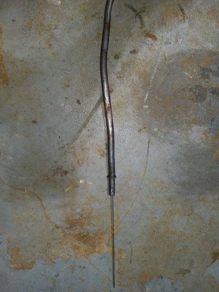

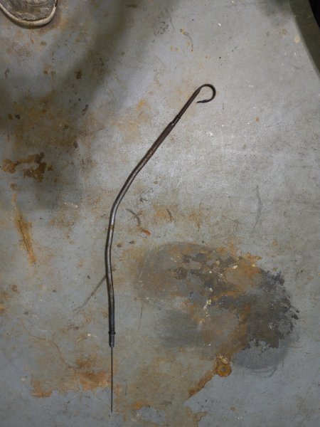

Here is the stick and holder off of my 440 HP 72 car.................
Can't you just bend it a bit so it doesn't touch anything?
