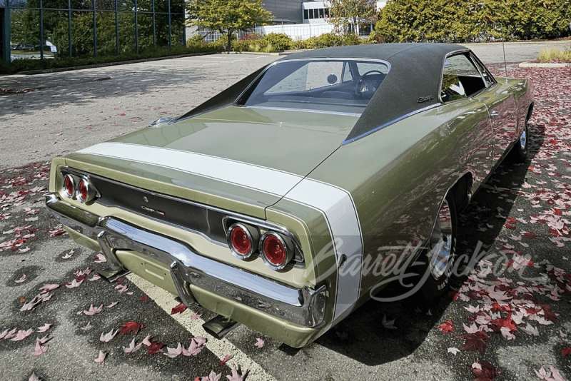

Just out of interest, what are seeing that is low quality?
Looking at the pictures (on my phone admittedly) it looks pretty good.
I understand the wheels are the wrong year but what else are you seeing?

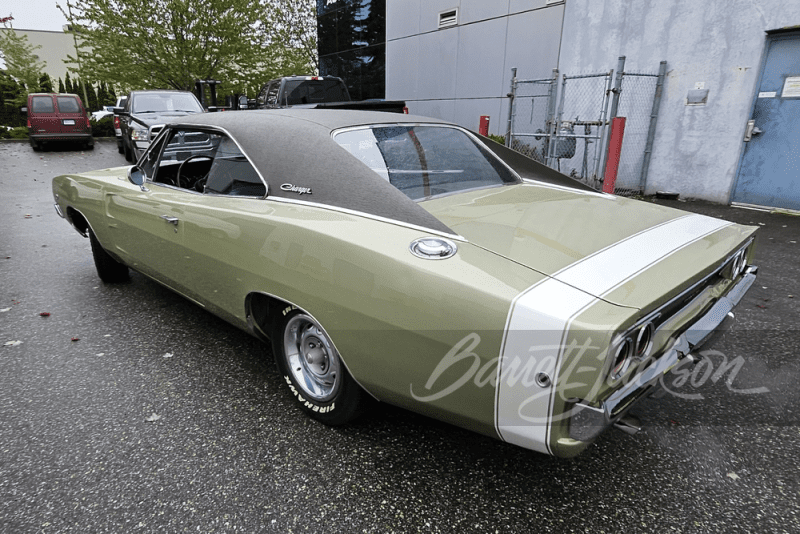

Overall it does present pretty well... The stripe is completely wrong, it's not an R/T so it shouldn't have a stripe but ignoring that it has the wrong stripe, the 68 stripe is the best from 68-70 but instead it has a 70 stripe...
Air shocks with flat rear springs is an interesting feature...

As mentioned, the goofy wrong stripe. But if you look closer at the lower valance and corner caps, they look a bit off. No license plate bumpers is a small detail that is skipped.

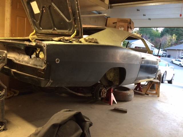

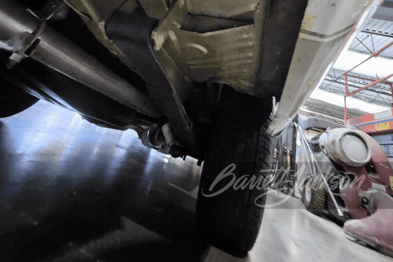

Cheapo replacemnet floor pan with no body plug holes. Also, notice the bend on the bottom of the quarter panel.

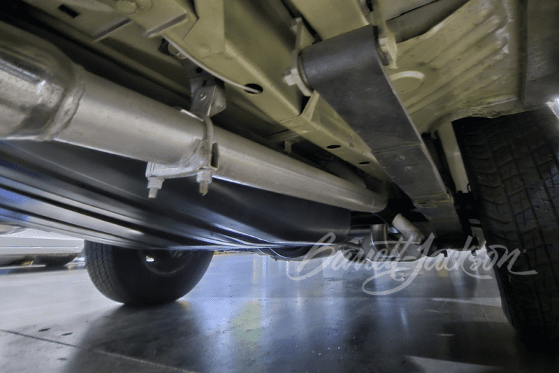

As mentioned, they opted for air shocks instead of installing new springs. Note the cheapo universal exhaust hanger bolted through the trunk floor.
Full quarters have been installed. How do I know? They didn't trim the excess metal that's showing past the wheelwell molding.

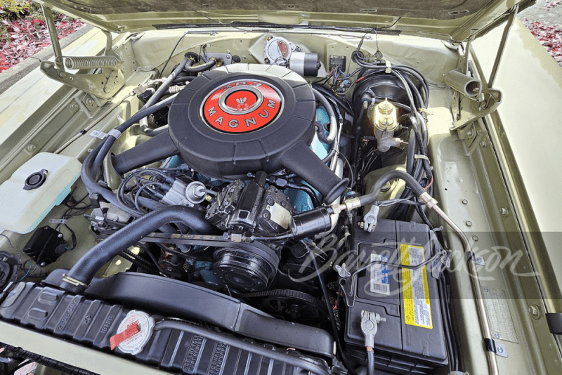

Overall, this doesn't look bad, but notice the cheapo radiator cap, cheapo batter cables, improperly run headlight vacuum hoses, wrong master cylinder, distributor cap, wrong PS pump & p. brake diaphragm, electronic ignition, painted rh inspection cover & I'm sure that a whole lot more could be seen in person.

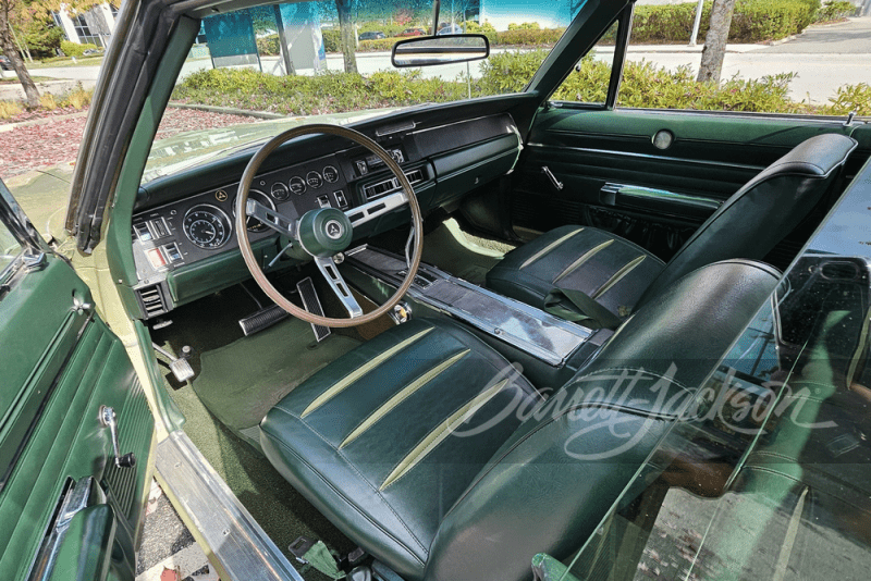

Overstuffed seat bottoms & it's hard to tell, but I think the dome light switch has been painted over. No public law decal.
The details I pointed out are often overlooked by the untrained eye, but I'd have to say that this car was a rot box that has had a sub-par "restoration". I don't think that I'm wrong in saying that this car looks better in pictures than it does in person, which was reflected in the selling price.

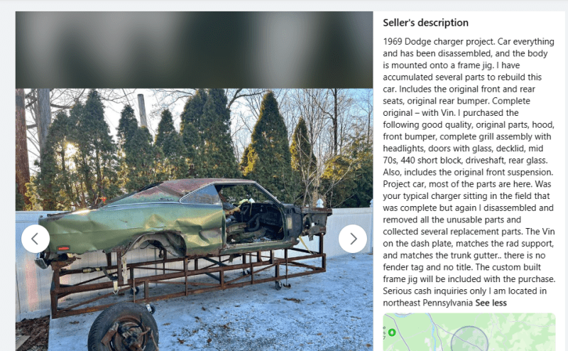

Ha, ha: Sure the basketcase is junk but I'm probably not the only one that started to formulate a plan on how to attack it with the $10k of AMD sitting in the wings waiting to be welded in. Painting it green would probably be part of the plan too, 318 not so much.
Save yourself a lot of time, money and aggravation and buy a car that’s complete and together. Preferably one that’s not a rot box.
That's the problem though. You have to be sure what you buy isn't someone else's perfumed rotbox that was incorrectly repaired. I can see buying a project like this and repairing it correctly but the buy-in has to be reasonable and you do it for the love not the "investment". My son has just spent another $40k on Hellcat engine and trans upgrade on this 68. You have to be careful doing that to something someone else has "fixed" and is selling you.
...and the rear spring eye bushes are flogged out (worn out).
