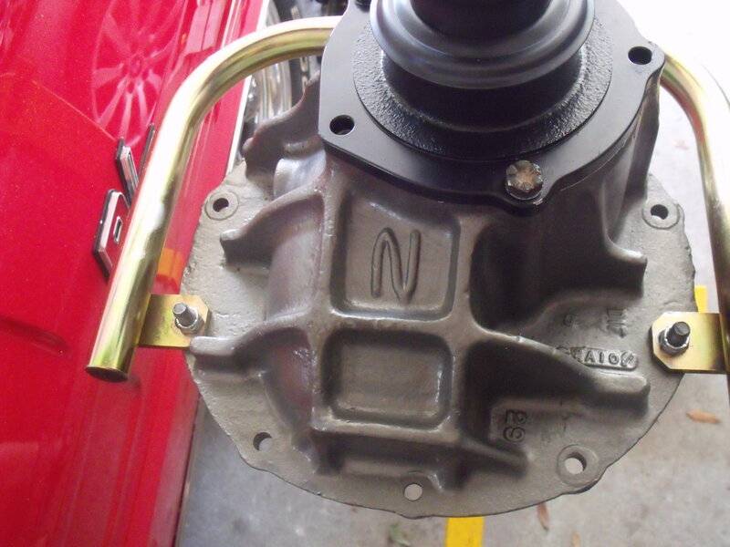

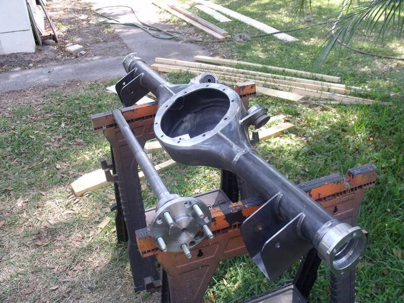

Way back in the early 90's I had Dutchman build a bolt in 9" for my 77 Chev stepside.. At that time I could not find any parts for the 10" or 12" ( can't remember) to work on what was in it....
It solved a multitude of problems with So many options available with a 9"...
Installing this one in my Mustang project right now.. Replacing the 7.5" that is in it....
