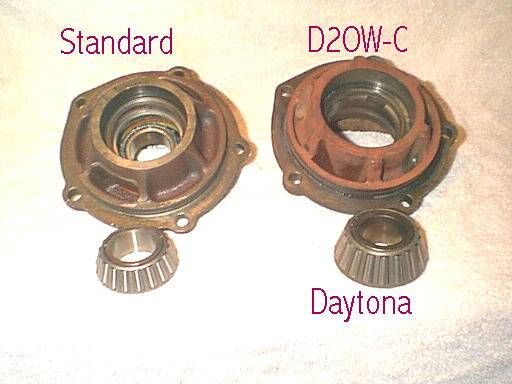

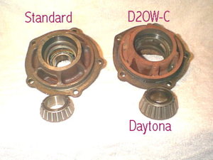

First I've ever heard of that storey. According to the Ford enthusiasts they've been that way since 1957. Would seem to me easier (cheaper) to have changed the bearing spacing and size rather than make a more intricate casting for the 3rd bearing, more machining, more parts etc if they had made that kind of mistake. Especially since if it were the size of and separation of the bearings that was at fault why didn't they just correct it with a different pinion support with larger bearings, like the one in the pic used with the nodular housings? As the horsepower got greater they used larger bearings, as large as a 60, and still had the benefit of a third support.
