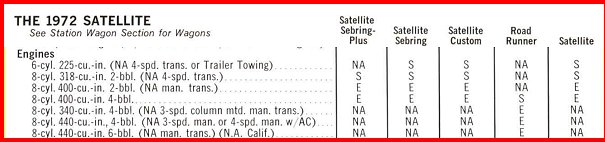

Actually the /6 was standard for all but the RR and GTX.
A 340 SSP would be rare if it was even available in a SSP. Would like to see the vin.
318 was standard in the SSP. 340 was RR only
