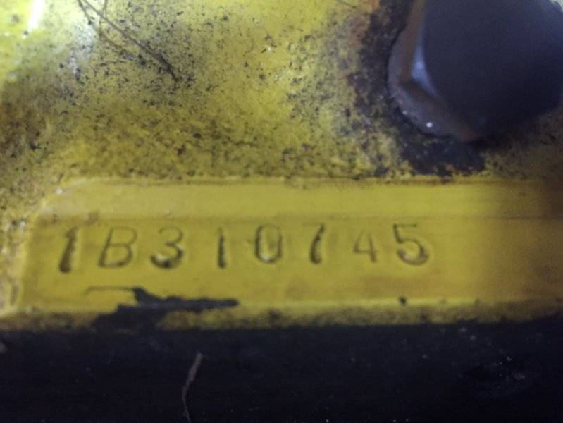

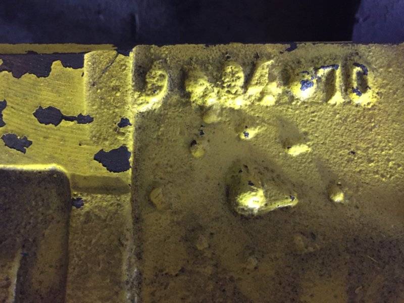

Found 340 block, casting numbers 2780930 340 3
Serial number GW340P33980190
Partial Vin 1B310745

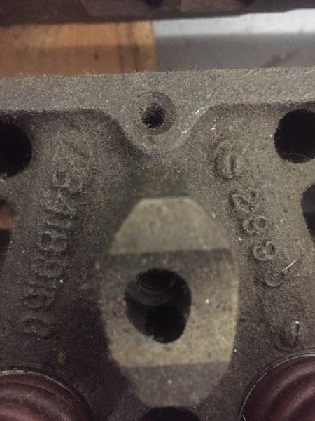

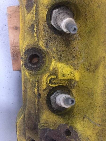

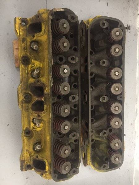

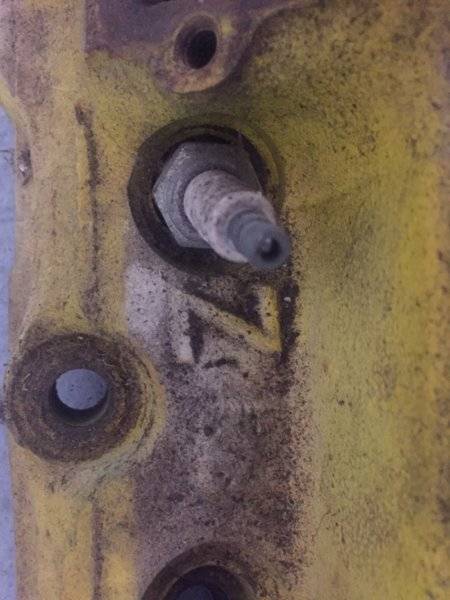

I also have the heads from this motor, 1 J head and 1 Z head
Just throwing it out there in case it can find it’s way to the original owner

It’s a 71 MY engine but since it came from Hamtramck (B in the VIN) it’s from an A or E body.
FABO or FEBO might offer better chances.
You might post it up on Forabodies and forebodies sister sites if your looking for its home. 340s were not offered in b bodies until 1971.
Well the VIN is 1B310745
That first 1 means it’s a 71 model year engine
But the B means it was installed in a car built at Hamtramck and in 71 it appears B bodies weren’t manufactured at Hamtramck...
But A & E bodies were
