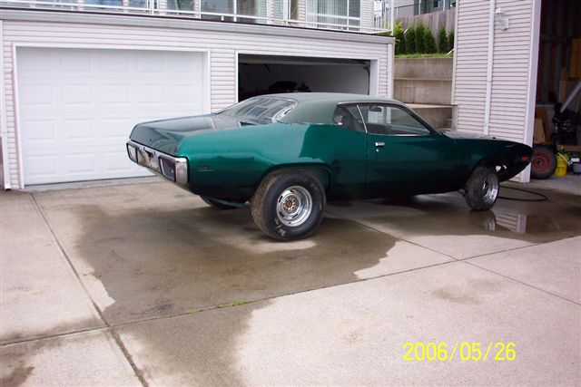

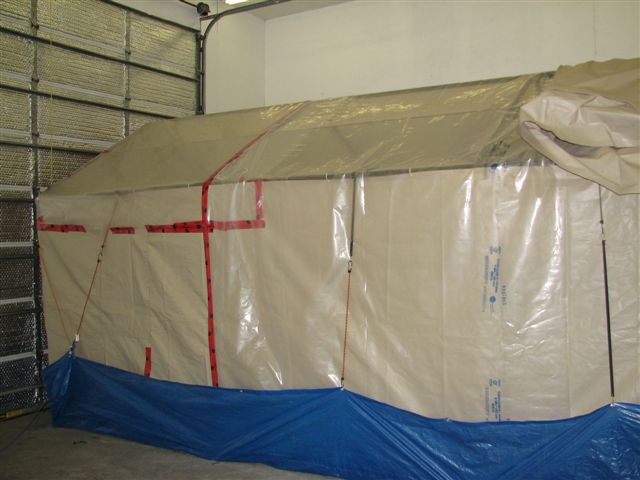

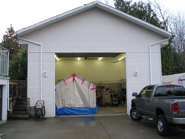

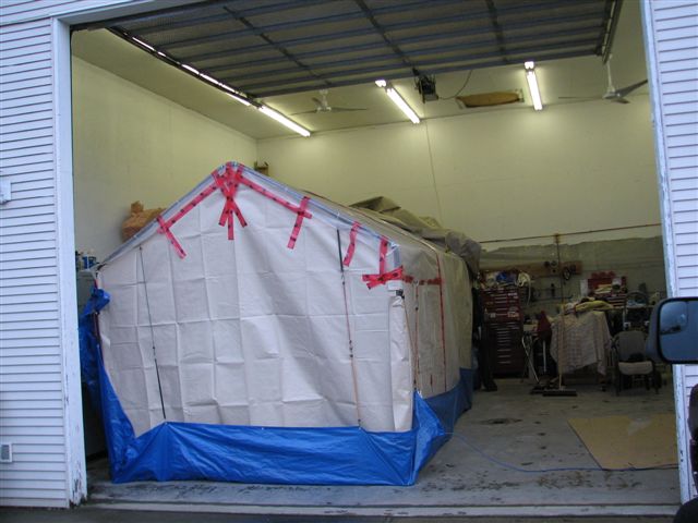

I see alot of good ideas on hear regarding makeshift sand blasting cabinets. I decided to use one of those Costco Tents for a blasting booth,intially intended on doing it outside in the tent, but with the very heavy rains coming on the West Coast, I thought I'd put the tent together inside my shop. Once I got it together, I figured I'd keep it inside where it's warm and dry! I then peeled back 3/4 of the roof, and put up clear poly to let more overhead light in. Works great, a huge tarp on the floor pulled up around the edges keeps the sand( actually copper slag) inside, where I can sift and reuse. All I need now is something for exhausting dust...o, that's my 72 Satellite I'm blasting.O ya..it's a tough job trying not to damage the new paint with all the sandblasting and welding that I'm doing. The knuckle head I bought the car from, did not fix the rust under the vinyl top or the trunnk, behind the bumpers,etc....fun!

LOL! That's a diet Dr. Pepper can! O the color is the 2003 or so Dodge Ram Timberline green....if I can't save the paint, I'll likely do a color change to a factory Mopar muscle car color.:rolling:

And...the tent will double as a paint booth,( maybe not for a great top coat job, but at least priming, trunk floors, accessories, etc).... after a powerwashing to get rid of the sand!

Maybe to exhaust dust and fumes I was thinking of peeling down the side wall at the peek of one end enough to mount and exhaust fan.
Maybe a triangular cut plywood with a gable house attic fan mounted to the plywood with a hole cut for the fan. Steel straps or cable to mount the plywood frame with the fan to peak of tent frame.
