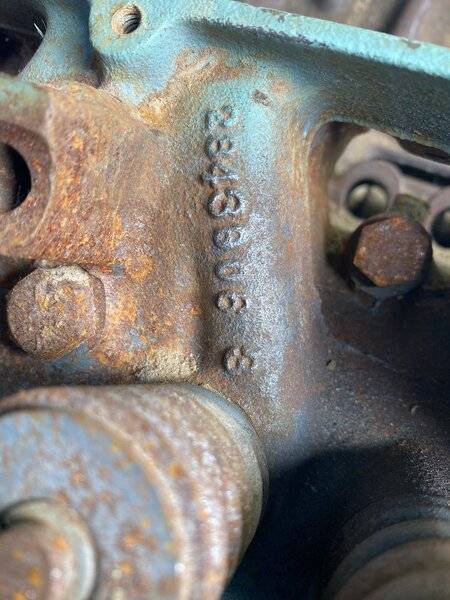

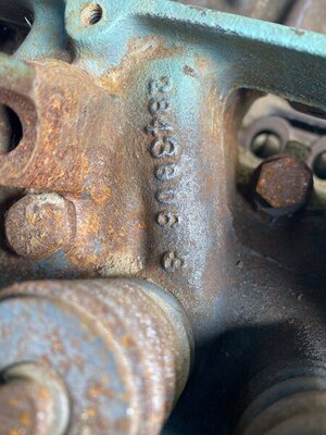

Once I’d bought the car, and did some further research I knew the heads on the engine weren’t original to the car(906 heads on a 73 charger 400 2bbl).

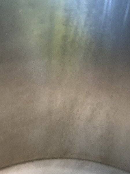

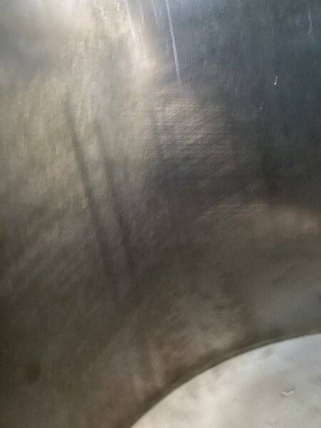

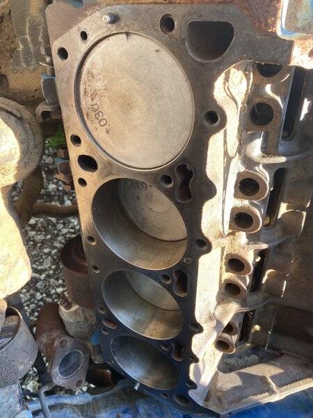

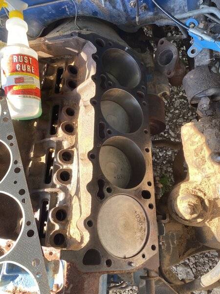

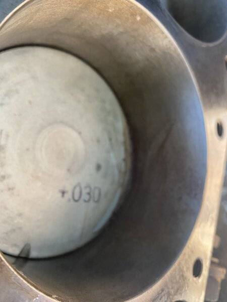

I opened it up today and was pleasantly surprised to find clean bores and new .030 over pistons.
I can tell they’re flat tops, but would greatly appreciate insight on how to determine an approximate compression ratio so a can make other decisions.

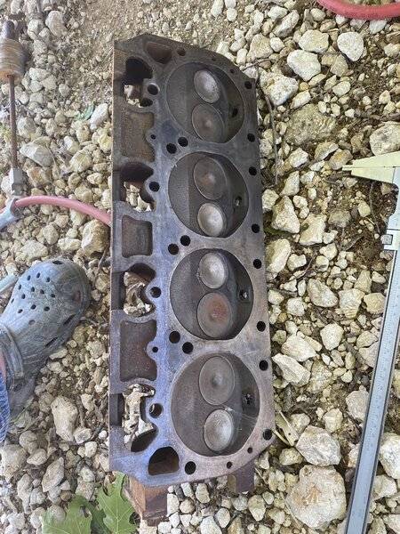

From removal I can tell the heads were redone as well and never run.

Do you have a set of feeler gauges? If so bring a piston to top dead center & measure to see what your deck height is....

If that first picture has the piston as high as it'll go I'd be putting different pistons in it... The bores are fresh a quick hone & new pistons.. You could reuse the bearings, if your totally on a budget you could reuse the rings...
If the piston comes up the bore further you might be okay... Measure it & we can tell you....
You should CC the heads too... Very important if you really want to know & it can be done cheaply...
The rust inside worries me.
Yeah, another reason the short block should come apart... I've seen worse & the engine still ran & made decent power but I personally wouldn't want to take a chance...

I agree with 1 Wild R/T. Those look like cast rebuilder pistons, and they look "down in the hole" a bunch at tdc. Chances are good that the compression is no better, and possibly worse, than stock. Measure like Wild shows, if there is .100 or more, likely 7 3/4-8 1/4 to 1.
The trouble with 400s, is there are lots of great pistons for stroker 400s, stock stroke not so much. You might have to live with what you have.
Once you have a deck height, you can get an idea (without precise measurements, it wont be precise) of what your c.r. will be, using c.r. calculators on the net. Without a measurement of the heads, figure around 90 cc's.

KB 240 is 1.908 which should be about .025 in the hole with 5cc valve notches... Not Ideal but off the shelf & a reasonable C/H...
Using 89cc for the chamber volume, & standard stroke/rod length/bore/shim head gasket etc...
The KB gives you 8.7, the typical rebuilder piston gives you 7.6...
Start reducing chamber volume & you can actually get somewhere... take .040 off the heads, use the KB & a shim gasket & you get 9.4.... Not bad.....
When Calculating.... measure how far down the hole the Pistons are at TDC.... then use around 2.4 CC's for each .010" down added to the clrc volume when doing a CR calc.

I appreciate it guys... there is no rust in the bores. Just some dust, I cleaned it up looks like good cross hatching still. I rubbed oil on the piston tops and the bores to be safe until I figure out next steps.

Looking at the head pic, you NEED to replace the springs due to rust, so get the springs that match the cam.
