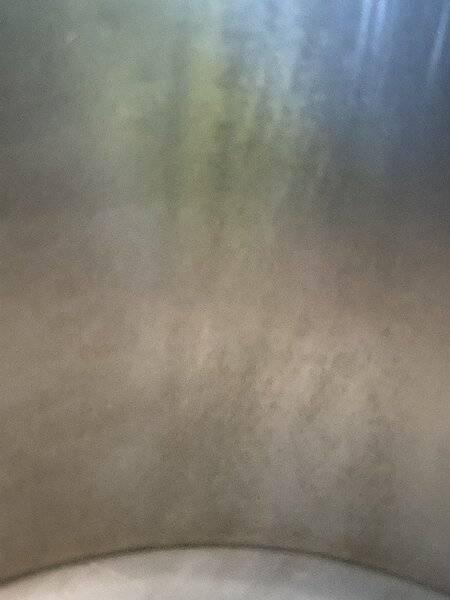

Another inconvenient/harsh statement nobody likes to hear ?
From the COMETIC Website
"A surface finish of 50 RA (roughness average) or finer, is recommended for a proper gasket seal. Anything rougher may conflict with the gasket design."
https://www.cometic.com/tech-support
Refers to both the Heads and the Block finish present.
