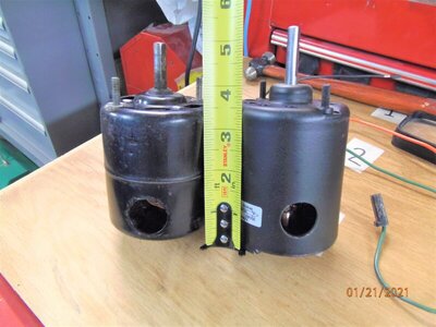

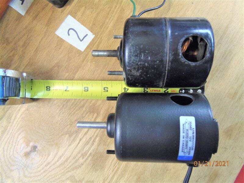

View attachment 1057698 View attachment 1057699 View attachment 1057698 View attachment 1057699 So, I'm going through my heater box on my 68 "X" and I figured that
I would replace the blower motor with a new one from Rock Auto for
$38.00 including shipping. I just got it and tried to put it in and the
"Clocking" on the housing for the rubber vent tube is off big time. The
motor has no name on it, only says "Made in Canada." You would think
Four Seasons would want to put their name on it! The studs for mounting
the new one are metric but thank God the shaft diameter is good! anyone
else have this problem and what did you do to fix it? Do you guys get new
blower motors from someone else and everything lines up O.K? Thanks!

I called Oreilley's by me and ordered a Murray PM350 blower motor. The listing
says it fits a 1968 Coronet but not a GTX????? I think I'm gonna let them order
it in an go match it up. Can't understand why it would be different. I'll let ya know!

Well, I'm off to FedEx to return the Four Seasons 35502 to Rock Auto. (Cooling tube hole clocked wrong) Wish me luck!

O.K., so I took my old one apart, cleaned it, polished the comm, and lubed it up. It's going back into
active duty! Screw it! The VDO and Murray branded motors that have part number PM-350 are clocked
wrong, along with the Four Seasons which is actually a Unimotor 35502 is also clocked wrong. The funny
thing is they are all listed to fit a 1968 Coronet, and some of them are listed to fit a 1968 Roadrunner.
My car only has 42k on it so that's that! Now to put in the insulation pad and the heater box while I
watch the Buccaneers and the Packers duel it out!
