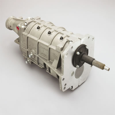

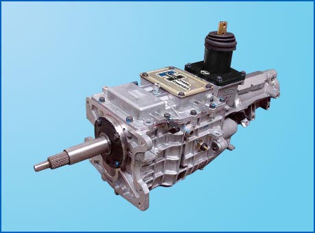

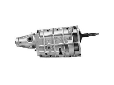

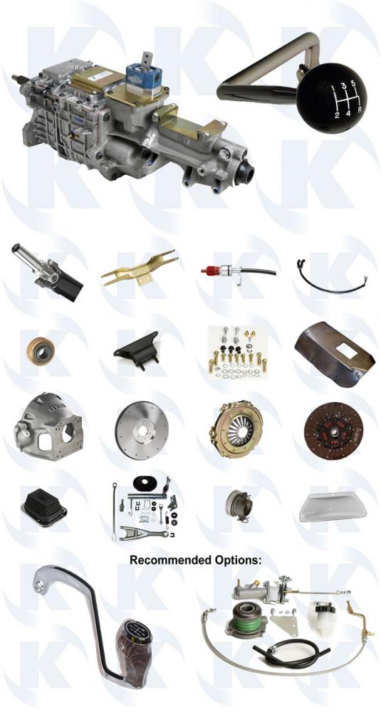

Lets all just beat that dead horse some more...LOL... Last car I went from a 727 auto to a manual trans, I went with a 5 speed, I used an 18 spline Doug Nash 4+1 it fit great, found it on www.Racingjunk.com complete with everything I needed for les than $2k, there's also Richmond 5 speed is another great alternative too, not really cheap, but you won't have to wait years to get one, the peddles & bell housing are the easy parts to find, flywheel too, BUT if you plan on going to the track by SFI rated stuff, make sure the trans fits in the tunnel, most of the newer 5 -6 speeds won't {without serious modifications, not that hard thou}, then there's the hump in the tunnel if you go with a stock type 23 or 18 spline 833 trans & linkages, cross-member, various clutch pieces/linkages, driveshaft yokes & drive shaft... I actually love manual trans cars, for street cars only, beyond that it's not very cost effective to run a clutch combo & be at all consistent or last any period of time, with out breaking the bank, if you plan on abusing it allot... good luck what ever you choose... Passon Perf., Brewers Perf., American Powertrain, Richmond 5speed Jegs or Summit Racing for about $2400 for just the rans & it's not an O/D just a 5 speed you can run like 3.23:1 rear gear & have a launch like a 4.56:1 gear, Doug Nash 4+1, Keisler is now gone, Liberty, www.Hurst-Drivelines.com & Legend Gear also all manual trans sources... Google any of them you will get a ton of links & threads/info... none are cheap, depends on your budget...
  • Transmission Keisler Mopar B-Body Perfect Fit Auto to Manual conversion kit.jpg
