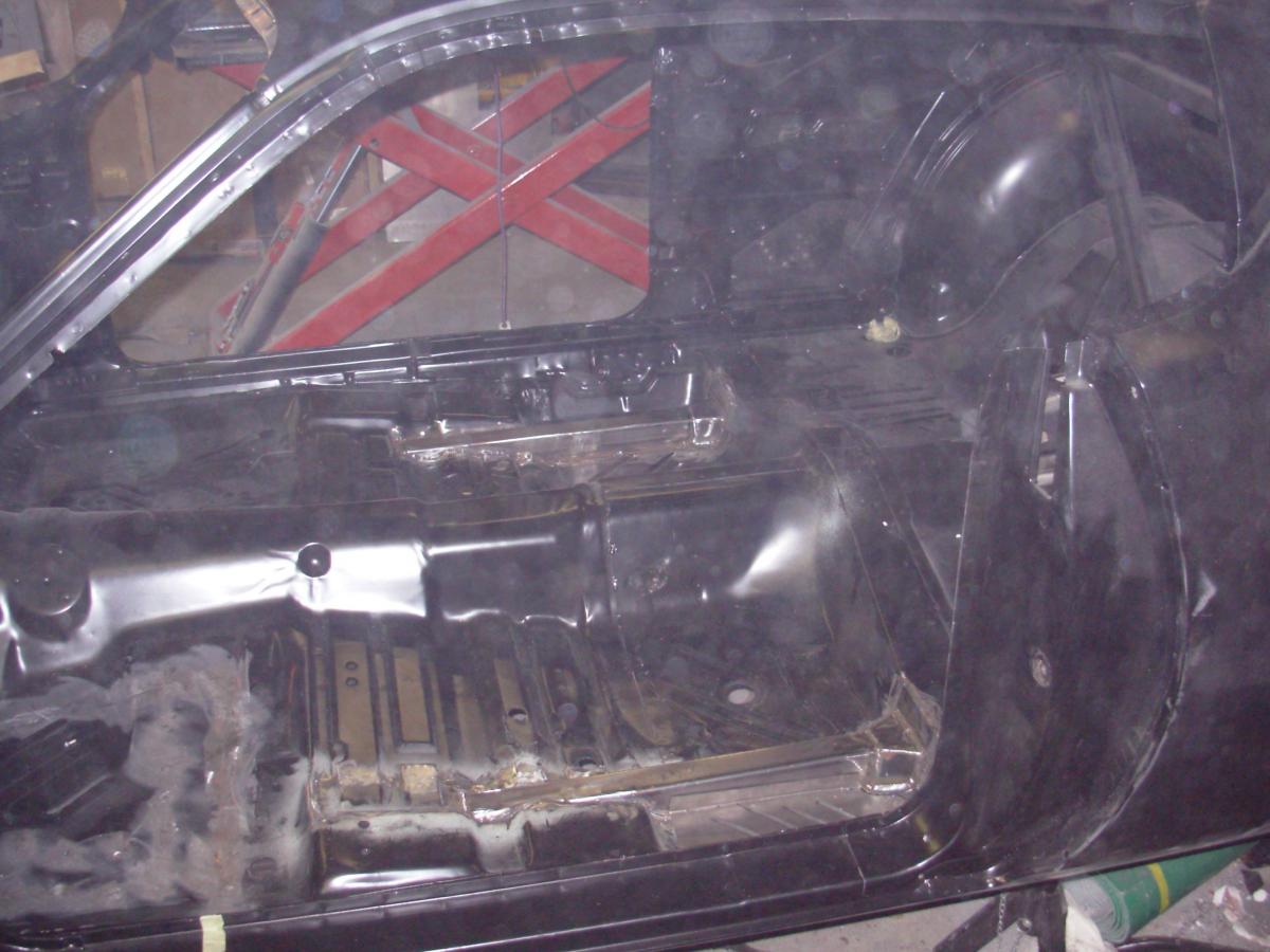

Hi guys,
I have my Charger stripped down now to finish the body before painting. I would like to make my own sub frame rails. Any good pictures????? I bought an older 6V71 street charger for the 440 so there will be more torque...and body flex! Not much boost, mostly for looks n street cruising.
Thanks, Gary

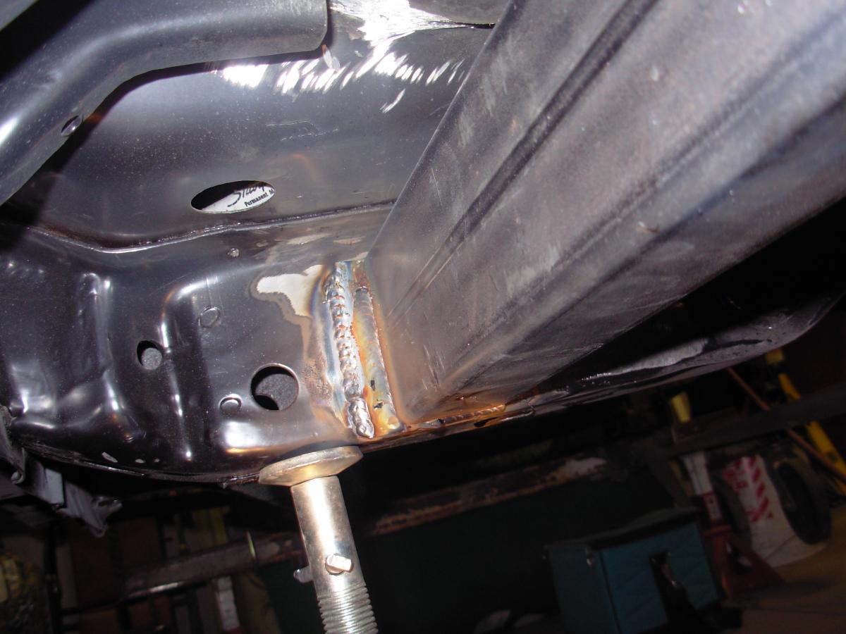

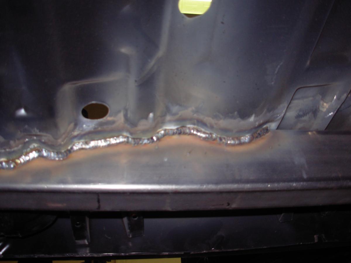

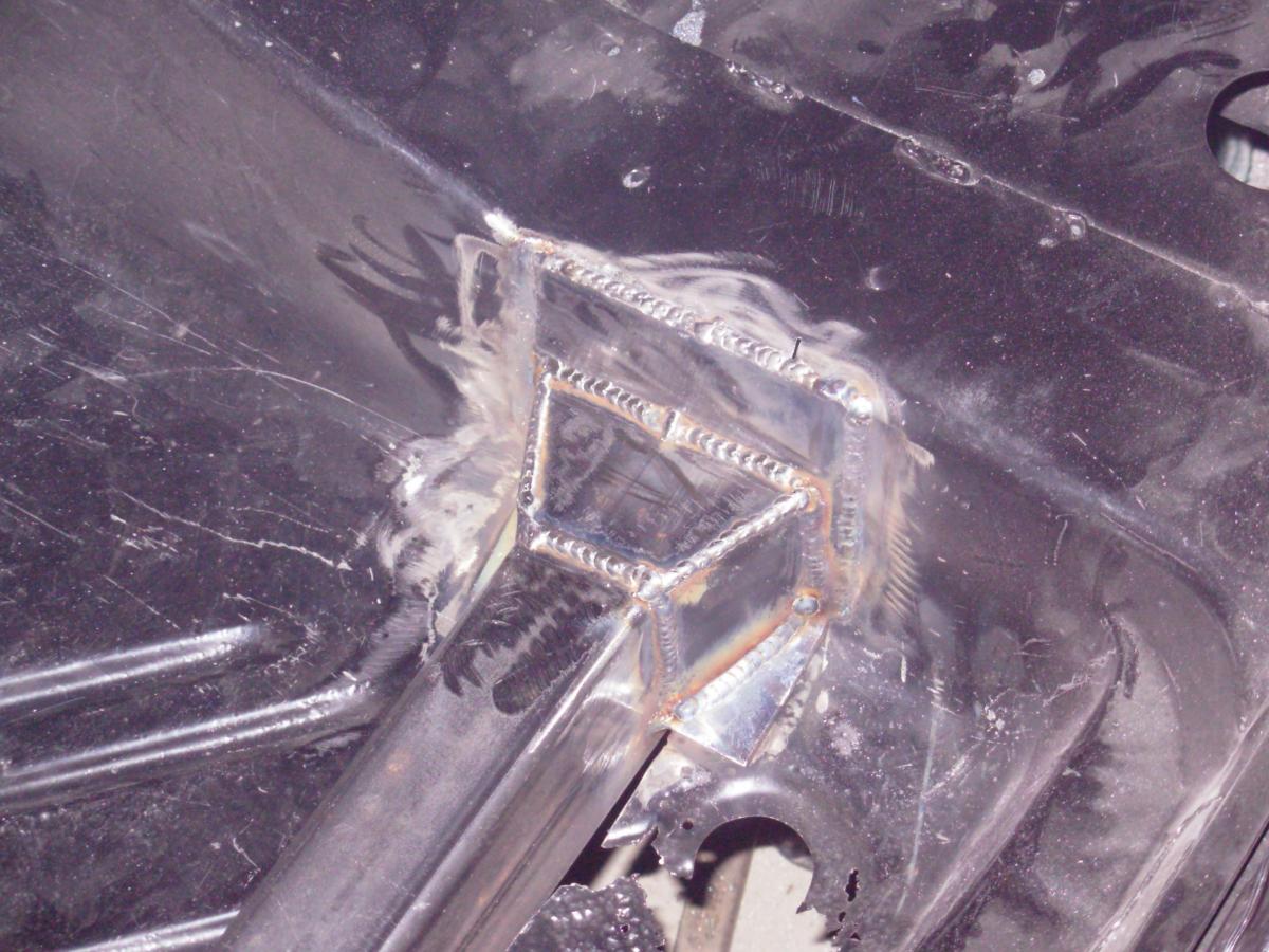

Hear are a few pics for the guys looking to add a cage or higher horse power cars.These are thru the floor 2x3 120 wall tubing.They are welded to the front crossmember and inserted into the rear rail 12" and plug welded accordingly.This allows for mounting of ladder bars to something ridgid.I don't have any pics of the round tubing under chassis connectors.Hope this sparks some intrest or some ambition.:3gears:
