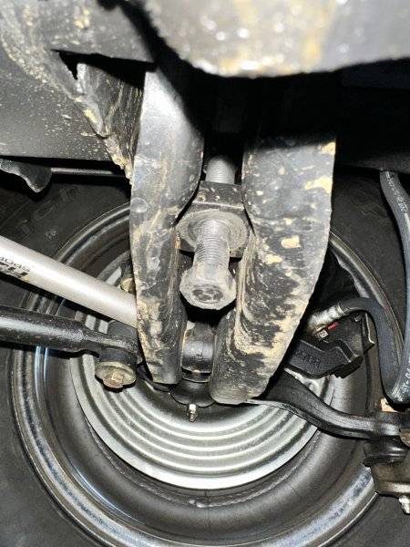

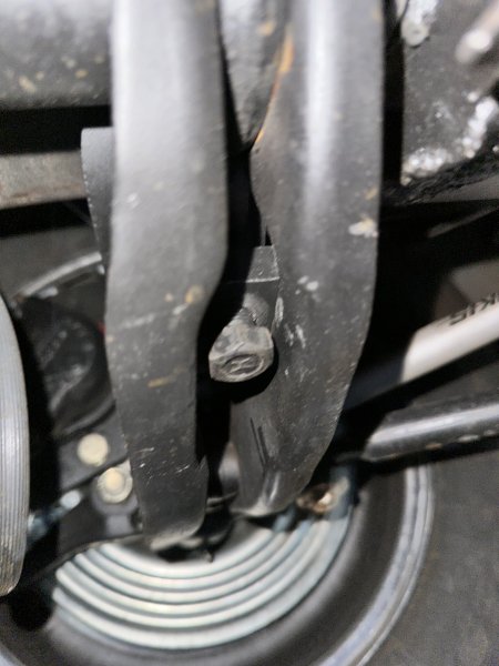

Frame hitting LCA ear
I also noticed the torsion bar adjustment bolt is way in on the driver side compared to the passenger side. Although the ride height is equal on both sides.
I'm thinking the hex is off on the one side. That or there's something wrong with the hex sockets at transmission cross member.
I see hotchkis strut rods.
This car have 1" torsion bars? That was the size PST? had hex issue with years ago.
dfrazz when you correct the problem please let me know the answer I have another car with the same problem on the same side THANKS
Thanks for all the input. Unfortunately this is the way I received the car and don’t have history as to why or who did this. The torsion bars are in the correct sides. I will pull the bar and shaft nut and see what’s going on with the tube and bushing. Also make sure the bar is installed correctly.
Bushing really looks messed up. Just a thought, any chance the lca’s could be mismatched. Kern Dog?
Now what

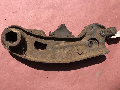

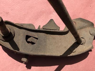

The A body LCAs are actually close to 1/2" longer from the lower ball joint to the mounting pin. To tell them apart at a glance, the A arm has a flat section across the bottom.
The B LCA is curved all the way.
Yes, as I found out from your well explained posts. What I am getting at is if the other arm is longer (it’s not pictured) for some reason, would it take less turns on the adjuster than the shorter lca. To adjust equal ride height. I had two of the same, wrong lca’s, so both adjusters were about the same.
Okay, good point. You can look at it as the leverage difference you see using a longer ratchet handle.
1/2” over the length of the LCA may not make much of a difference.
Quick Update - I was able to work on the Charger some yesterday and pulled the torsion bar. The LCA bushing looks good so I aligned the LCA and the torsion bar to make sure it is straight and reinstalled it. Again it took way more turns on the adjusting bolt to get it to near ride height of the passenger side but the ear was not hitting the frame. I took it for a quick spin and came back and the again the frame was sitting on the LCA ear. I am thinking the torsion bar is shot so I ordered new 1.03's from PST and will see if that fixes the problem.
