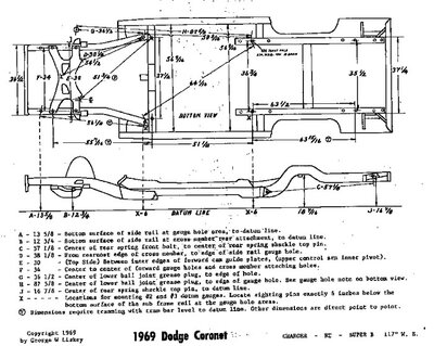

Cost me around 500 in steel and a buddy and i set it up to all the factory specs i found online. Prob took a few hours. Made out of 2x2x.25 or .50 if i remeber right. That was the base. Welded stands for factory holes in the frame rails( not pictured) if i remeber when i get a chance ill get a picture of it with the car on. The picture would essentially be the datum line the the stands would be to the measurement from that line.
Car fits it like a glove. I bought a tram gauge for when we set up all the stands and when we put the rails in. Not sure it its necessary per say if you replace one rail at a time. But I would..
My 2 cents. Every one hase there own way of doing things and no one way is right so just do your research and be comfortable with the direction you choose to go.. picture below is just reference of what i did i believe plymouth was a .25 longer beween rails or something? I just remember when i bought frame connectors them saying there was a difference between the two. So do your homework.7016293-6556156-Frame69Coronet.jpg

Great information as always. My only question so far is how wide are you making them ? It looks like the frame is anywhere from 37 1/2" to 36 1/2" so what is a good size to make it so you can still work around it.
@hemi446 looking at the diagram I would probably make the table so the outer rails of the jig line up with the bottom of the rockers.
@5wndwcpe nice jig, and you're right - looks like around 40" would do the job just fine. I'm reading some of the other threads right now on this and they most of the others are about that size. (Reading the build with SGTPaul had one a similar size.)
