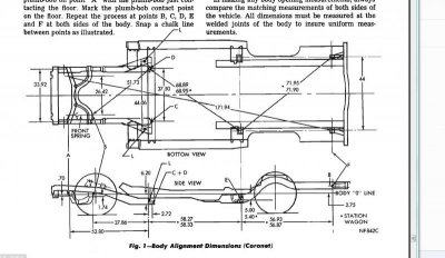

Wondering if anyone has or knows where a guy could get ahold of frame and body measurements for a 1969 Coronet, just putting in new rh front frame rails and fender apron. Car was hit in past and not confident in the alignments, would love to have more info before any welding happens. Any help would be appreciated. Thanks everyone.

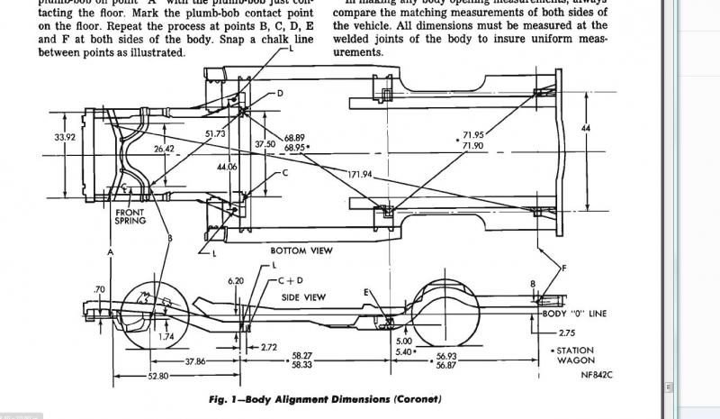

Wow thanks Propwash, very much appreciated. The people on this site are the absolute best!
One more question if you don't mind, do you happen to have any measurements for the shock towers and Upper A-arm connection points? Thanks again.
Upper control arm locations are not dimensioned in the factor service manual, unless I am just not seeing them. If anyone finds the dimensions let us all know.
