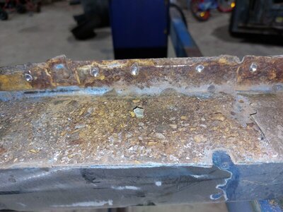

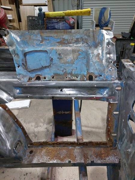

Hi all. I Was in the first stage of cleaning up my engine bay, cutting and smoothing it out. First part was the battery tray, at some stage in its life it had been given a fibreglass patch. At least that won't rust.

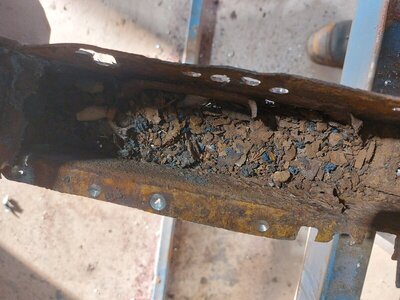

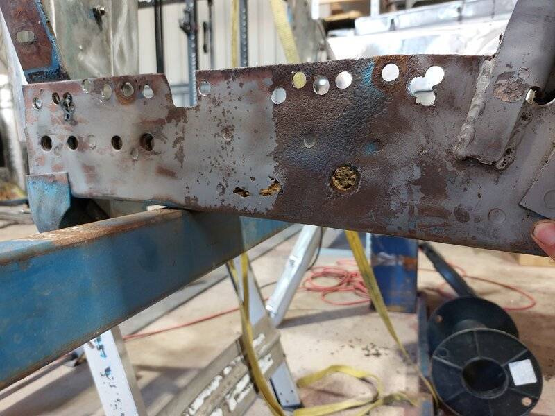

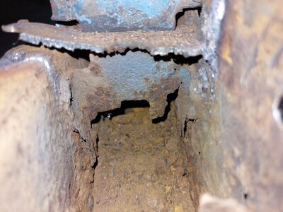

So I cut that out and then thought about making the frame rails look nicer by boxing the top in. My plan was to drill all the spot welded plates on top of the frame rail and replace with one plate welded on and given a smooth appearance. I didn't worry about using my spot weld drill bit because those parts are going anyway. Once I got the tops off I found the frame rail to be rusting from the inside out.
First question, how hard are they to replace?
Any good threads to follow on replacement?
AMD are out of stock. I see Sherman have some on summit. Are they any good?
In the last image is that part of the shock tower?

Clean it up. You may find that its only a small section. My 64 had some rail rust in the same area. I cut it out and welded a patch in it. Been coming down on wheelies for years. No issue with it at all.

I would like to but it's rusted through 2 sides and not far off coming through the inside wall, so the front rail would be relying on a butt weld amd I don't think it would hold for long.
More common than anyone want's to believe. There are concourse restored cars, besides thousands of drivers, out there with that hidden in there.
I agree very much. If I didn't pull that top plate off I would have never spotted it. But now I've seen it I can't unsee it. I need to fix it or else I won't be able to enjoy it.
Mines butt welded. 2 sides. It wheelies pretty good every pass. No problem.
