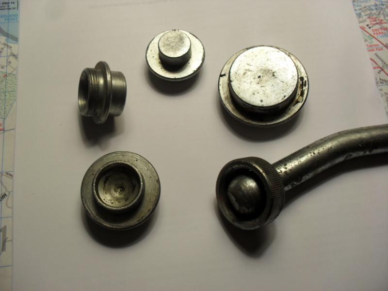

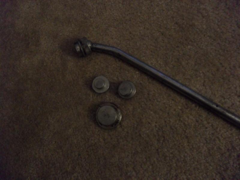

Bought this freeze plug driver from Mac about 40 years ago haven't worn it out yet.Just unscrew the driver from the head match it up to the freeze plug diameter and pound away does some steep angles.
