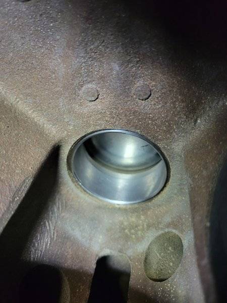

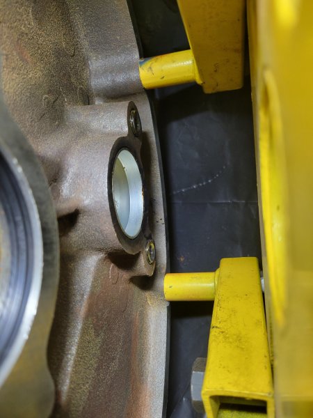

Another follow up, I took a look at a mill I'm building, the machine shop boys put it in flush. Which is what I would do, the step is in too far. You gain nothing going further inView attachment 1830376View attachment 1830377
Definitely not true in my case. If you look again at the removed core plug there was a good 1/4 of the plug which is the most wide that never was compressed.
