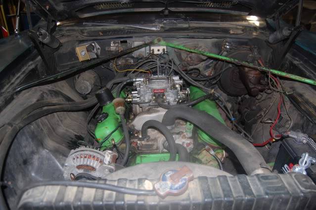

Heres what I started with, black spraybombed bay, lime green engine...Yuck!

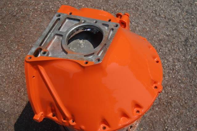

Found a crack in my bellhousing, I had to get welded up.
Bellhousing Painted.

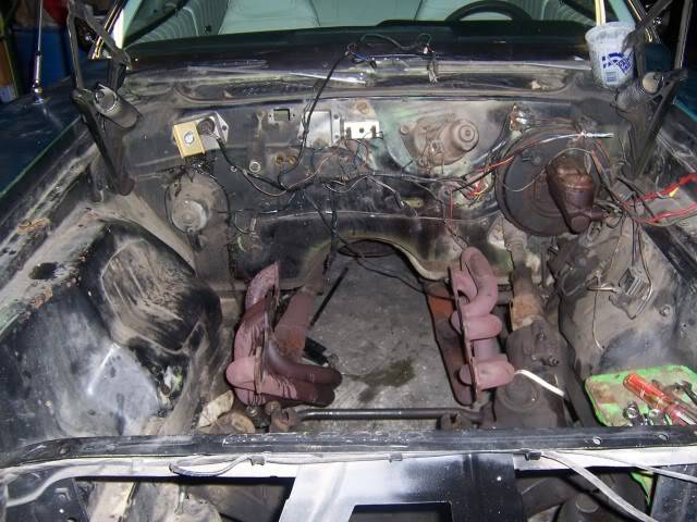

wiring and parts removed to start prepping for paint.

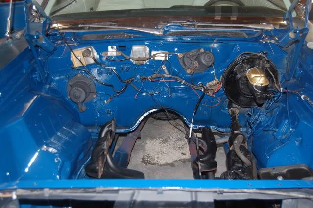

Bay painted. I used a pre-packaged single stage urethane, picked out a shade of blue I liked.
Wiring and parts reinstalled.

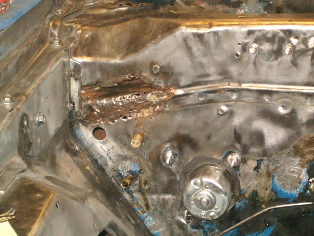

here a a few pics of mine i have some rust issues i have to deal with :mad:
