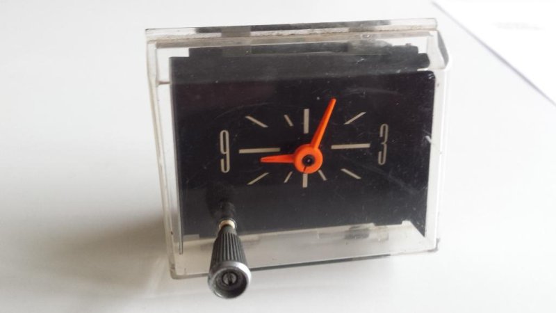

A while ago I was looking for a clock. My car was a lot car from Florida originally, and had no options except for AC.
So I wanted a clock that would work and keep time accurately. This almost immediately excluded the original clocks. I bought a defective one though, for the original look

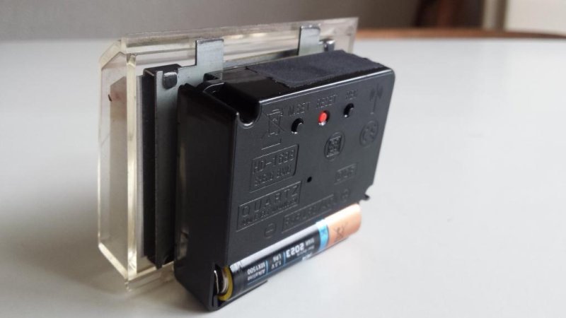

And disassembled it. I replaced the clock mechanism with a DCF radio controlled unit.
This works on a Atomic clock in Germany that broadcasts it's time over a 77 kHz radio signal throughout Europe.
In the US they have something similar, WWVB Radio Controlled Clocks.

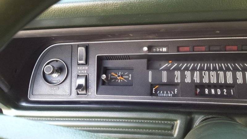

It always keeps perfect time and goes automatically to daylight savings time and back. This is what it looks like in the dashboard:
The clock's knob doesn't do anything anymore, the seconds needle is gone..
